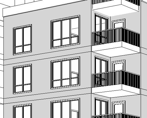

Hello,
I'm fairly new to Revit (Arch 200Shadey and have generated a 3D perspective view of my project and I'm noticing that the floor lines are showing through the siding in the view. The floors are aligned with the exterior face of core of my walls, which are subsequently covered with a 3/4" siding (I've increased the width of siding as well to see if this was the problem). I'm unable to select the lines with the linework tool in the perspective shot to make them invisible. The strange thing is that when I zoom in on the view, the lines disappear. Any idea how I can get these to become invisible? I don't want to turn the floors off in visibility graphics as I don't want to be able to see through the levels. Thanks!

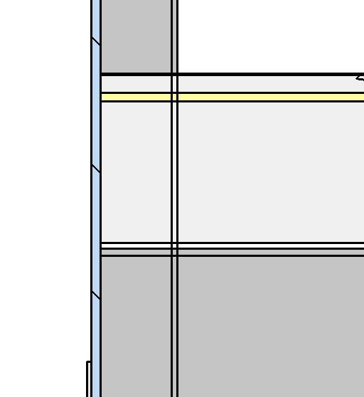

Tue, Apr 15, 2008 at 2:01:28 PM | Floor lines showing through siding in perspective...
Cut a detail section through the wall at the floor and post it.
Tue, Apr 15, 2008 at 2:44:26 PM | Floor lines showing through siding in perspective...
Pmerk
Joined: Fri, Jul 20, 2007
13 Posts
Here's how it looks. Thanks!
Tue, Apr 15, 2008 at 3:10:14 PM | Floor lines showing through siding in perspective...
OK - if I read your components correctly, it does look like your floor is short of the exterior.
REVIT sometimes shows lines on our display which do not print.  Since these floor lines go away when you zoom in, they may be that anomaly.  Print your view and see if they show up in print.  I'm betting they don't .

Tue, Apr 15, 2008 at 3:46:04 PM | Floor lines showing through siding in perspective...
Pmerk
13 Posts
Unfortunately, the lines do print. Below is an example of what's showing both on screen and in print. Thanks again for the help!

Tue, Apr 15, 2008 at 4:10:24 PM | Floor lines showing through siding in perspective...
Pmerk
13 Posts
I would if I could Smile. The line work tool will not select them. It's as if Revit is thinking "you can't select those, they're not really there". Smile
Tue, Apr 15, 2008 at 4:21:55 PM | Floor lines showing through siding in perspective...
#9
nOT SURE WHY THIS IS HAPPENING BUT TRY THIS JUST TO SEE WHAT IT DOES.  i NOTICE THAT YOUR WALLS RUN THROUGH YOUR SLABS.
Not sure what is happening but try this to see what it does.  I notice that your walls run through your floors.  Click on the floor and choose edit - then tweak the layout by moving one of the floor sketch lines (you can move it back later ).  When you finish, allow REVIT to cut the volumn of the floor out of the intersecting walls (it will ask you).
See how that affects your views.
Tue, Apr 15, 2008 at 4:37:21 PM | Floor lines showing through siding in perspective...
#10
Pmerk
13 Posts
Thanks WWHub, I noticed that too about the floor and wall relationship. Unfortunately, it did not resolve the issue. It corrects the detail (the walls no longer penetrate throught the floor), but the floor lines remain in all 3D views...

Tue, Apr 15, 2008 at 5:05:10 PM | Floor lines showing through siding in perspective...
#13
Pmerk
13 Posts
I added a layer to the wall between the core boundary and the siding and varied its width (from 1/2" to 2" ) to no avail. I changed the material of this layer to a variety of settings as well with the same results.
 "This doesn't just happen" - you're starting to feel my pain Smile
Yes, my exterior wall is continuous from top to bottom. When I pull the floor line back to center of wall core, the lines on the exterior disappear. If I have to use this as a workaround, I will, but this will effect any detailing that we were going to have Revit do for us.
