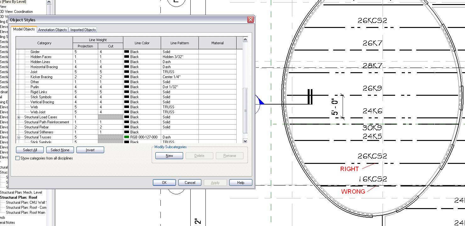

I am having some problems with the linetypes of my web trusses. Some of the types are showing correctly, and some are not. I have posted a screenshot showing the problem area and the Object Styles. The problem seems to be tied to the type as the linetype changes if I change the type, but they are all from the same family so I don't know why this would be happening. Any ideas on what may be going on?

I haven't done much with trusses but does 'Usage' come into this at all? i.e. Girder, Other?

The usage is set to Girder, but changing it does not effect the linetype.

Visibility Overrides in the view?

No overrides in VG, no element overrides. I tried to apply an element override, and that didn't change anything.
