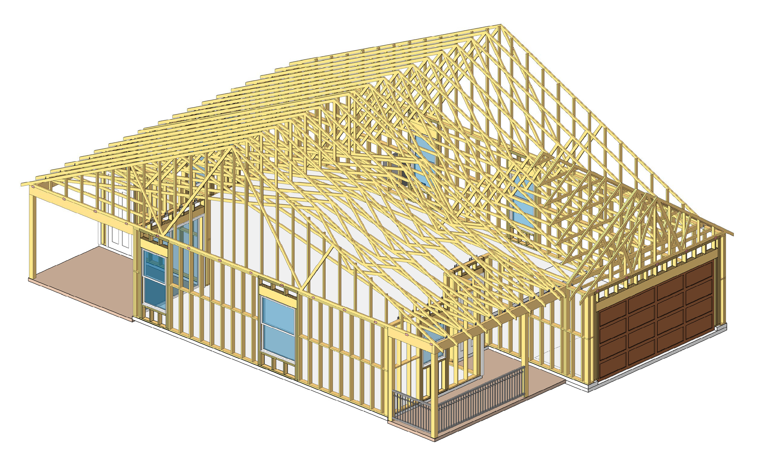

Is this what are you looking for?

Ok, thats nice.  How did you do it?

1.  Create doors andwindows family with all studs, headers and all framing.
2.  Create wall using railing.  Verticle studs are balusters and horizon studs are railings, 2-studs at top, 1 stud at bottom and 1 at midpoint, spacing the balusters as you need.
3.  Insert doos and windows on the plan and fill between with stud ( railing).
4.  You should create one stud-railing for corner that end post with 3-studs.
Once you create all families, it should not take more than 1-2 hours to complete you framing.
Create both 2x4 and 2x6 and the height can be any height you want.
Hope this help.

If you create a wall using a railing family does that effect the results of a structural analysis?  Or does it?  Revit looks at it as railing not a wall correct?

So do you use an "invisible" wall type to place your windows and doors into?

This railing wall with 5 1/2" stud will fit inside 6" wall with 5 1/2" structure core with 3/4" plywood exterior finish and 1/2" drywall finish.
You can hide either wall or railing.

Oh sure...nifty.
