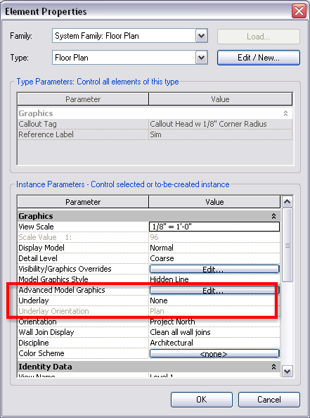

Basement rooms are showing up on my Main Level Plan as well, causing overlapping of room colors.
I tried view range, didn;t help.

make sure you have underlay for the view set to none
see attcahed image
