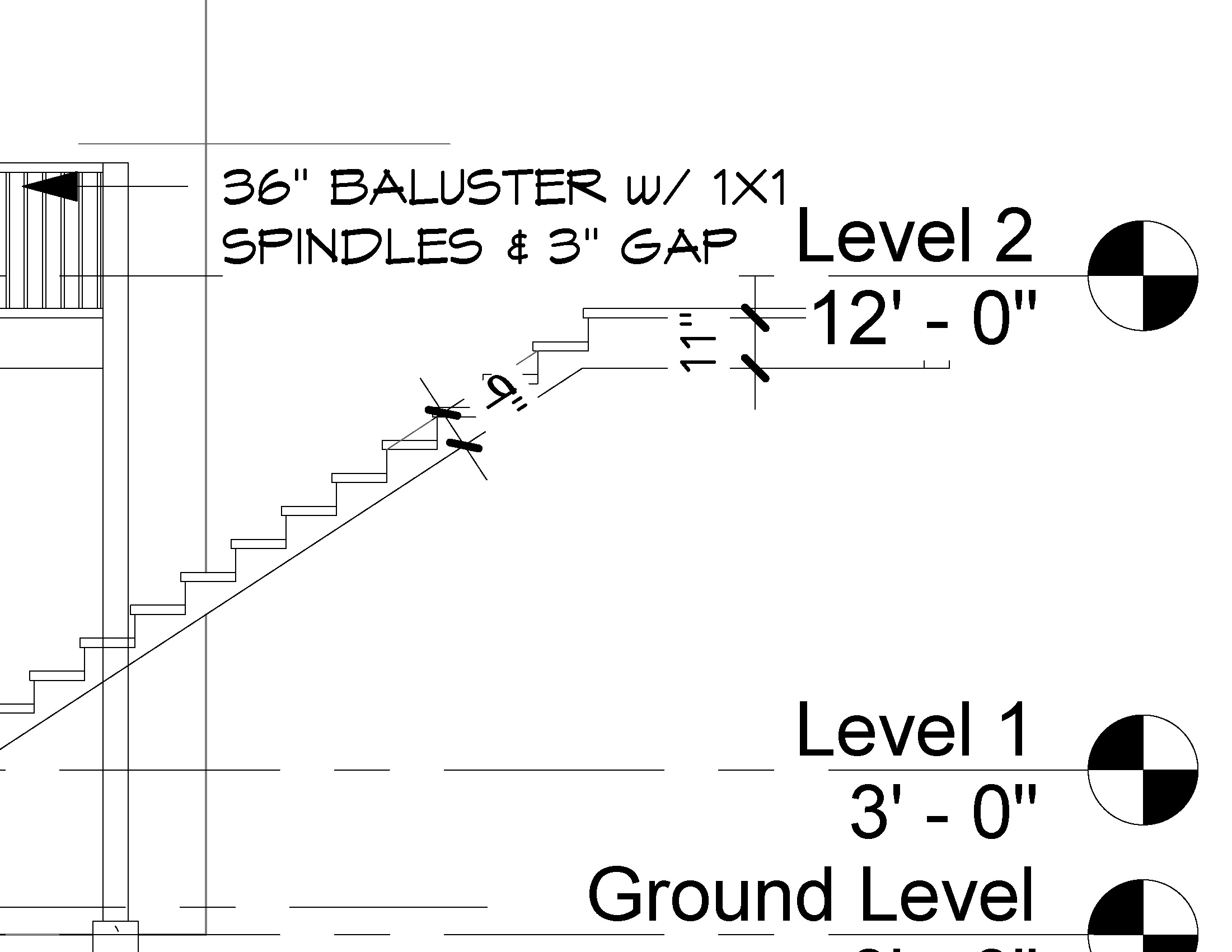

hey all; anwser to this Q. might already be somewhere here so could someone point me to it or just give me a hint? I need to adjust stringer thickness at the threads (check out the attached pic: see where it says 9" I need that to be about 11"[2x12]; I am sure you guys know where I can adjust that... thaks; Luke

you can adjust what they call the carriage height
you can see that the default carriage height is 2 1/2" in my example
so you can see in my example if i add 2 13/16" to the carriage height.
i get the 11 inches you are after. this is just one proposed solution. i am sure there are others
that will be posted if this does not work for you.
See Video Below
http://screencast.com/t/RlgyxCbUDB
