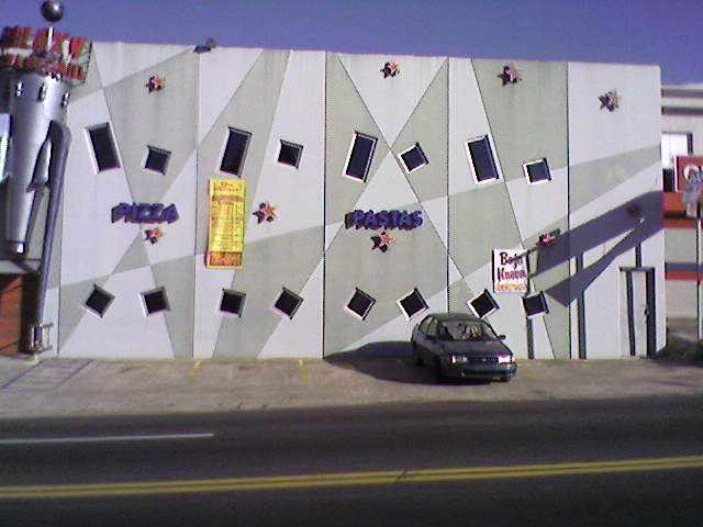

Is possible to apply an angle parameter to void to replicate this windows?

Here's a window template with an rotation angle parameter.
Angle Parameter in family
