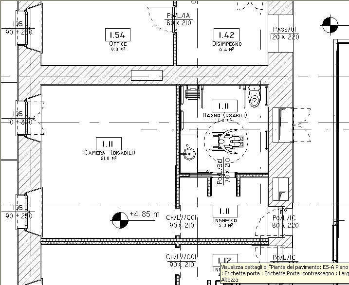

Mon, Nov 24, 2008 at 7:23:25 AM | Wall Niches
torinobox
Joined: Wed, Aug 27, 2008
1 Posts
I used the method Mr.Spot suggested to create wall niches and it works perfectly.

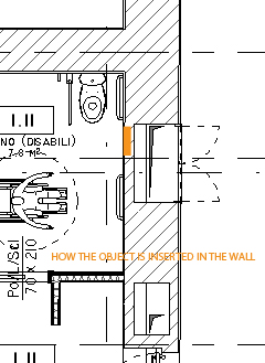

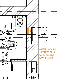

My problem is that I'm working on the renovation of a XVIIth century building Cryingconverted into a hotel) and we have added doors to the existent wall niches, so that we can use this spaces as electrical/sanitary control rooms, therefore we now need to attach some elements/equipments to the part of the wall that remains inside the niche, but when I create a Generic Model wall based family (with a void for the equipment and the equipment inserted in the void) and try to insert the family on the wall, it can only be placed on the outside part of the wall; and if I try to do a mirror with the control arrow of the family, it says it can't be done because the object is not cutting anything.
Does anyone have any ideas on how to create this? Please see attached drawings for a better understanding.
