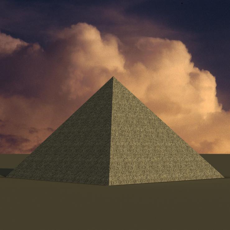

A pyramid is a simple sweep in Revit. If you’ve used the sweep tool to generate say a baseboard, you’ll notice that when your path turns to a 90 degree angle, the corner of the sweep gets mitered. In effect, a pyramid is just a plain sweep with a triangular profile mitered at four sides.
This is one of the uses of this Pyramid_Parametric.rfa. The dimension was based on the proportion of the Cheops pyramid found on this link: http://www.phantomgallery.64g.ru/pyramid/pyr2en.htm. Of course, you can change the proportion. The family is parametric (base length/width and angle) created from a simple sweep. http://www.littledetailscount.com
