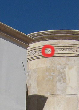

Wall sweep is such a handy tool, but i wonder if there is a way to add some elements perpendicular to the profile, to repeat horizontally.

Any pictures of what you're trying to accomplish?  Wall sweeps and reveals can be placed both horizontally and vertically, and then stretched, but that can be tedious for vertical elements.  Horizontal elements can be loaded directly into the wall type.

I would like to achieve whats in the photograph. And, the other picture shows how much i could achieve with Revit so far. So i need to add the pattern in red circle repeated together with that wall sweep.
