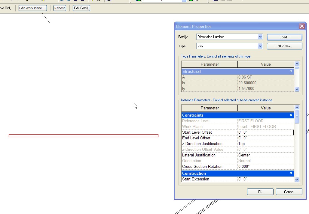

Tue, Apr 8, 2008 at 2:41:45 PM | Roof Rafters
Try placing your trusses from a plan view.  Place one and look at it in 3d.  Youll figure it out from there.
For rafters, load an appropriate sized wood structural componet and place it in plan stretching out the ends as you need.  Right click on the rafter and goto element properties.  What you will get looks like the attached file.  In that interface, you can set the height of each end.
drawing angled roof rafters
