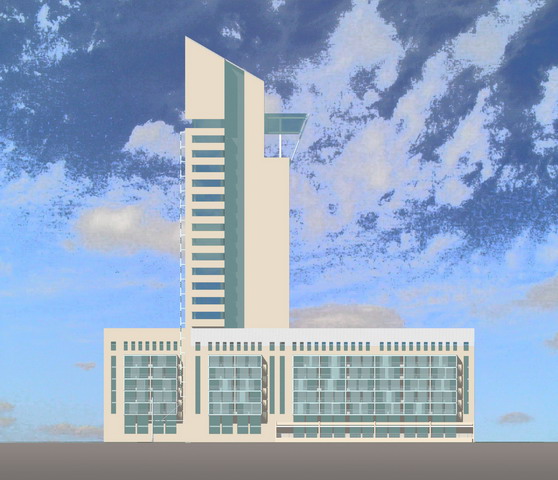

Hello When I put background in perspective view, like sky or street scene, in rendered view that image always is corruted, is not useless, or in elevation render ... Image is jpg or bmp. thx

In setting/environment/background image/ and then I put some image

you're doing it the correct way. what happens to the image?

That is example, is it possible that only me have this problem

when exporting the rendering, what colour depth are you using? Almost looks like 256 colours?

Here is original background image and above you have render, that is problem. And for me it looks that drop number of colours but how

I Just did a test rendering using your background and it came out fine. Check in the rendering settings for the view under environment and background image, that your opacity is set to 1....? That's all i can think of at the moment is there is no option in revit to change the colour depth... (that i can find)
