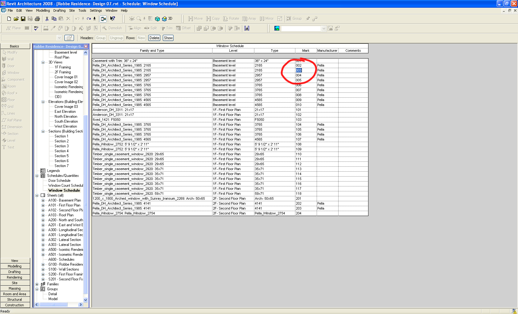

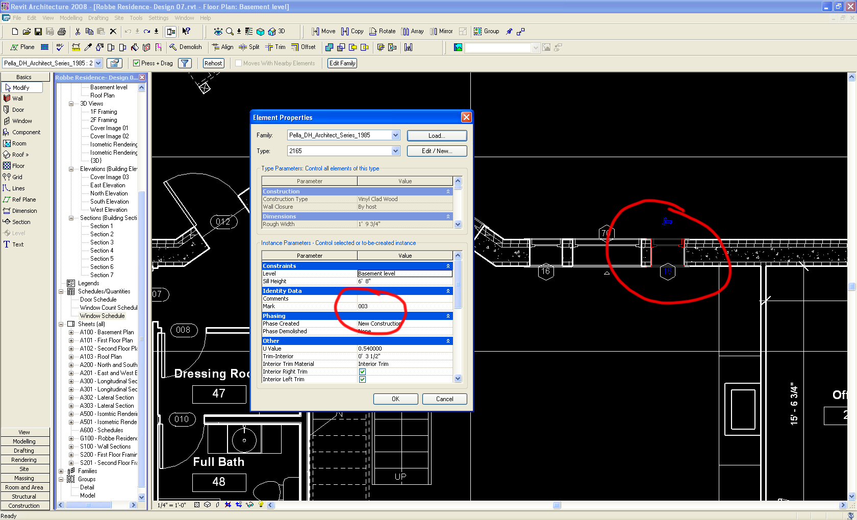

Hello all,
I'm having an issue with some window tags in my project. As you can see from image 01, I've given all the windows in my project individual numbers. In image 02, the window that has been selected is shown as having the Mark "003" in the properties window. However, in the window has a different mark in the model. I'm having the same problem with all my windows. How do I make the mark on the schedule and the mark on the model match? Am using Revit 2008. Thanks!
Wed, Apr 2, 2008 at 10:55:07 AM | Window tags displaying differently from schedule
Your window tag has to look at the same parameter as your schedule.  Change one or the other so they both look at the same data.
Wed, Apr 2, 2008 at 11:33:28 AM | Window tags displaying differently from schedule
Coffeefiend
Joined: Tue, Oct 2, 2007
36 Posts
I must be missing something- how do I change the data at which my window tag is looking?
Wed, Apr 2, 2008 at 11:44:36 AM | Window tags displaying differently from schedule
Your window tag is a family.  Edit that family and under it's type values you will find the parameters it uses.....
Read up on Parameters in your HELP.
Wed, Apr 2, 2008 at 11:49:15 AM | Window tags displaying differently from schedule
Coffeefiend
36 Posts
There we go, they're all working fine now. It was just as you said. Thanks very much!
