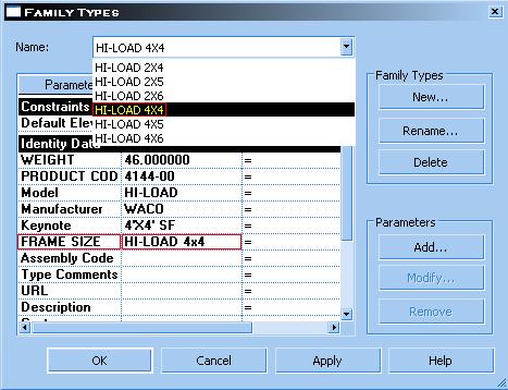

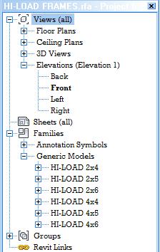

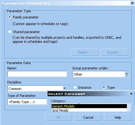

So you've created 5 seperate families and loaded each of these families into a single famiy, right. Now you should have 5 generic models inside the "ultimate" family (you dont need to place any of these onto the canvas yet. Next will be to Add a <Family Type...> parameter (leave it as type, not instance) and select Genric Models from the Subcategory list. You will also need to create a Family Type for each of the families you've loaded into the "ultimate" family. Now when you select a family from the drop down menu, you will need to select the correct family for the <Family Type...> parameter created earlier... Now, place one of your models onto the canvas and give it the Label of your <Family Type...> parameter. DONE.
