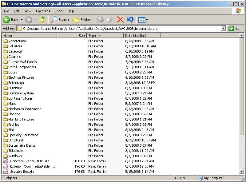

For Families: Use the file structure provided by Revit. Name your files what they are. Take a look at how people name their files in the downloads section. If you want custom content to show up first use a prefix that will place the new files above the standard content. (-_0)

Create a Revit library on your office drive. Reset, the all of the pathway links (settings>options) to this library- instead of each persons "c" drive. As you build your library, you do not want people loading imperial library components willy-nilly. You also, want to create and link to your own template file will all of your typicals loaded in.
