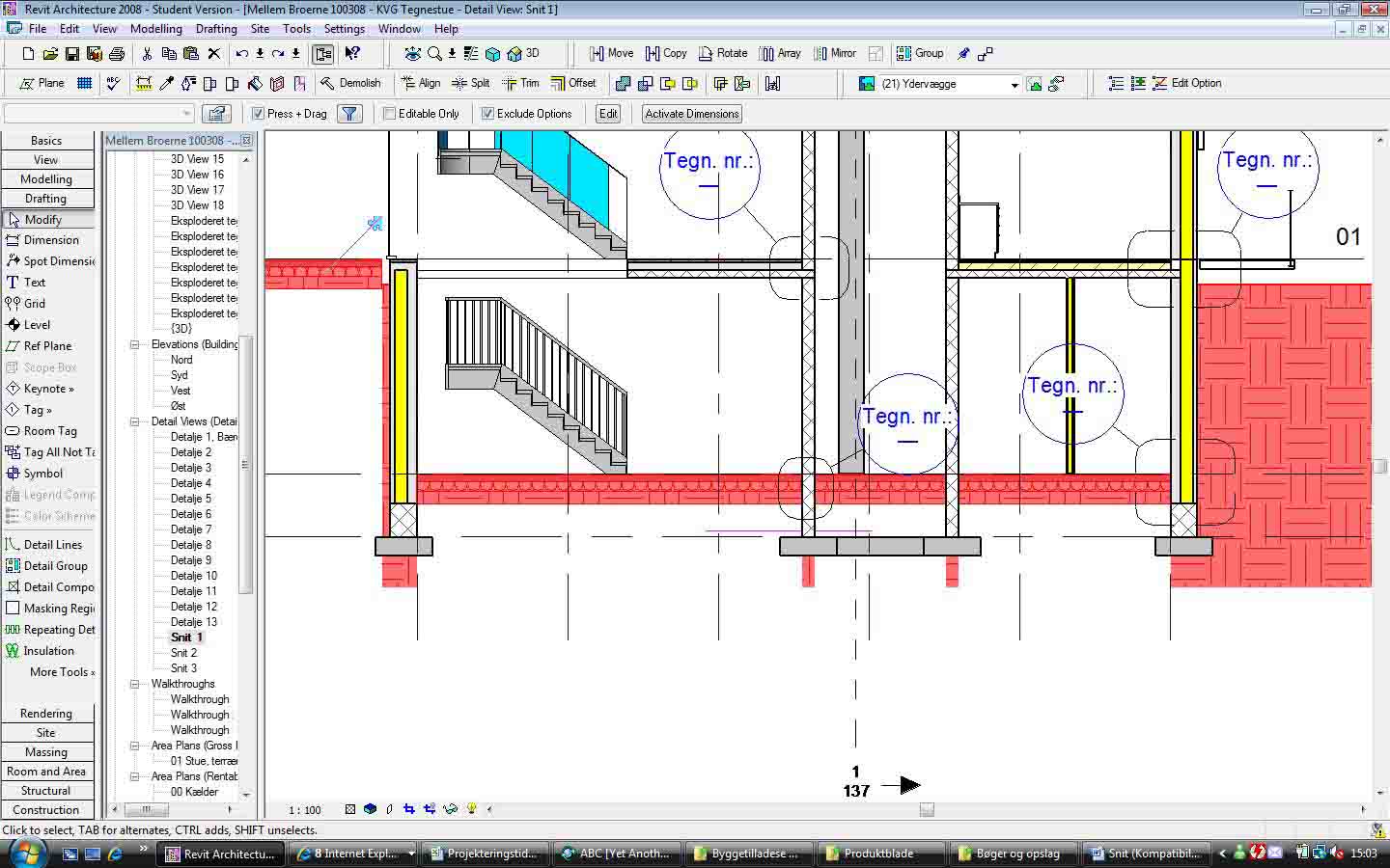

Hello Experts.
I have a problem with my cellar floor. I mistakenly made it as a pad (almost the same as the floor function), but the wierd thing is that i has a connection to the rest of my site, and a other pad. I can't choose one of them. Only connected. And i only want to delete 2 of the elements. Also notice the wierd toposurface bits under the fundament. I cant select them. Look at the uploaded picture.
No, they are not connected to a group.
How can i select only one of the now connected elements.
 Kind Regards Peter

2 things, first may be stupid but have you used the tab key, turn off all other objects and see if you can't still select it.
also see from your image you are using worsets, make sure you have permissions to edit the workset.
hope this helps

Thanks for the reply. Yeah i tryed the tab. But thats not the problem. Its when i select it, i select all of it. Not one of the objects. As you can see on the picture.

With "Filters" or "Isolate the Category" and then try to select.

u have to make sure it say that its the pad you are selecting, if u select the site it will also pick the pad, this is normal.
