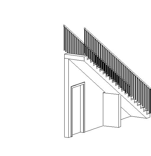

I was trying to build a small bathroom on the underside of a staircase. I can attach the wall to the staircase by editing the profile. But my question is how do I attach the smaller wall to the underside of the stairs? (see attachment) I end up with it either penetrating the stairs or not attaching as I want it to... Another question. I've seen Mr Spot's tutorial on how to attach a wall to a curved stair (great tutorial as usual;Winking But is there any simpler way to do it?

I think you can try do a section thru the staircase, open up the section and create a in-place wall family using extrude and just align the sloped/ parallel line to the underside of the staircase... btw, where to find Mr. Spot's tutorial on the attaching wall to the curved stairs...link please & thanks

Nope i don't mind, i actually uploaded the tutorial here about 6 weeks ago now but still hasn't shown up. Guess the guys are really busy working on the site... in elevation, draw a reference plane to align with underside of the stair then select the wall and use attach top to attach the wall to the reference plane. HTH.

HTH.I know this works with straight stairs, but my question was if there was an easier way to do this on spiral stairs other than the tutorial you made.

Not currently. Other method it to split the wall at each tread and then drag the top down to the underside of the stair (but if you have a smooth underside than my tutorial is currently the only way). Try the Revit 8 beta...

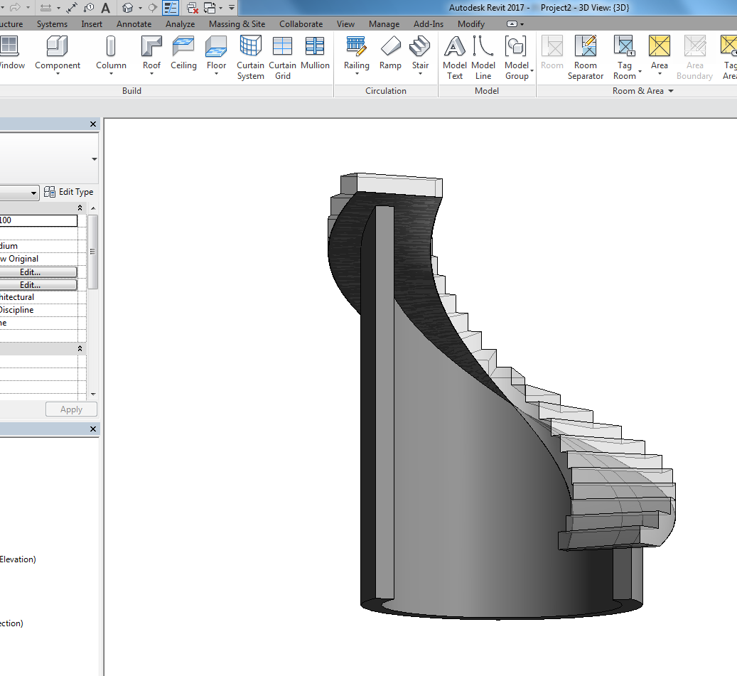

PAL, THE BEST AND THE ,UNFORTUNATELY, MOST "EASIEST" WAY IS TO CREATE A MASS SURFACE AND APPLY WALL BY SURFACE

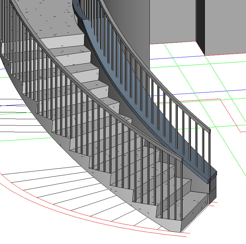

Hi
I just created a 1mm thick floor below the stair. using shape editing tool1
then i attached wall to the floor. then i gave the same material of stair to the floor
then attach the wall to top
