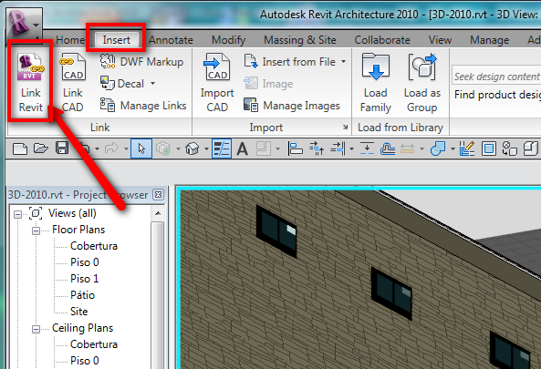

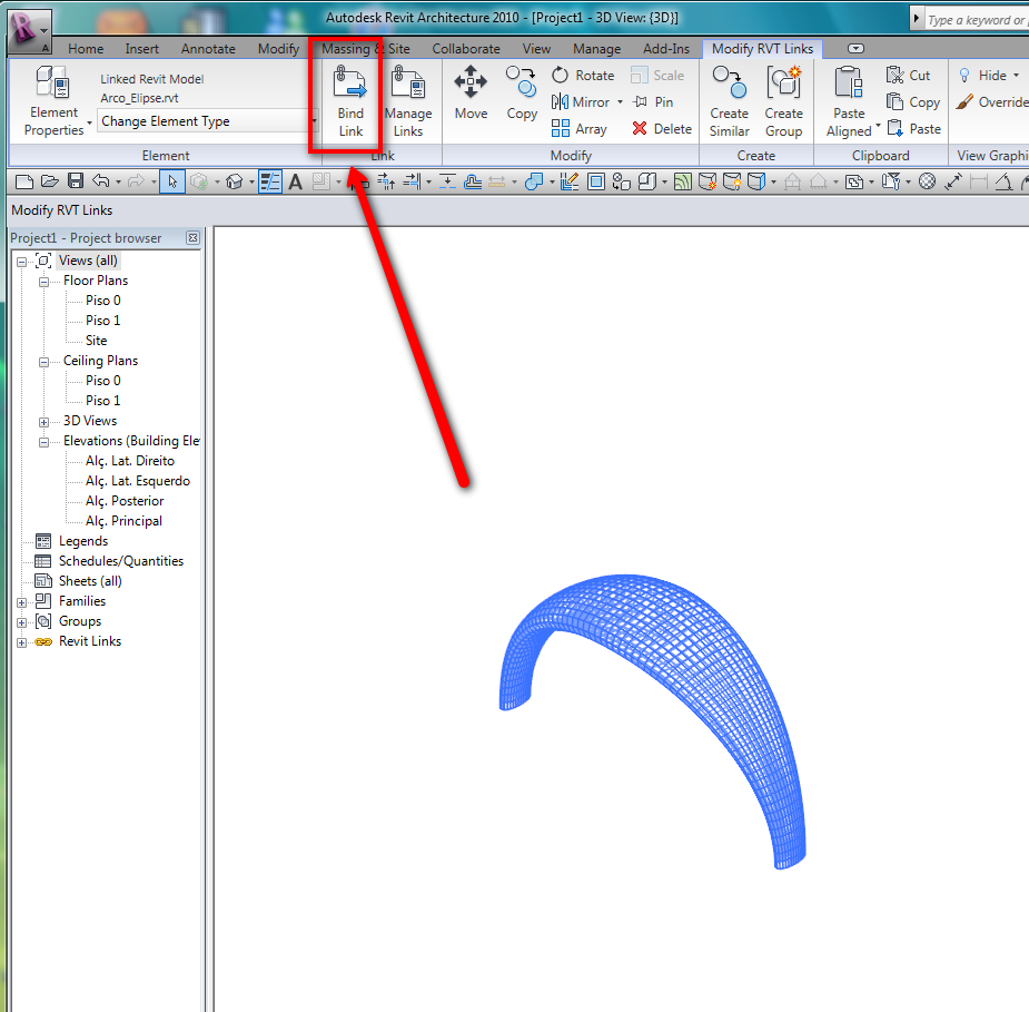

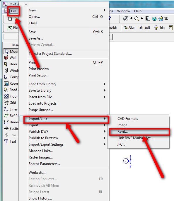

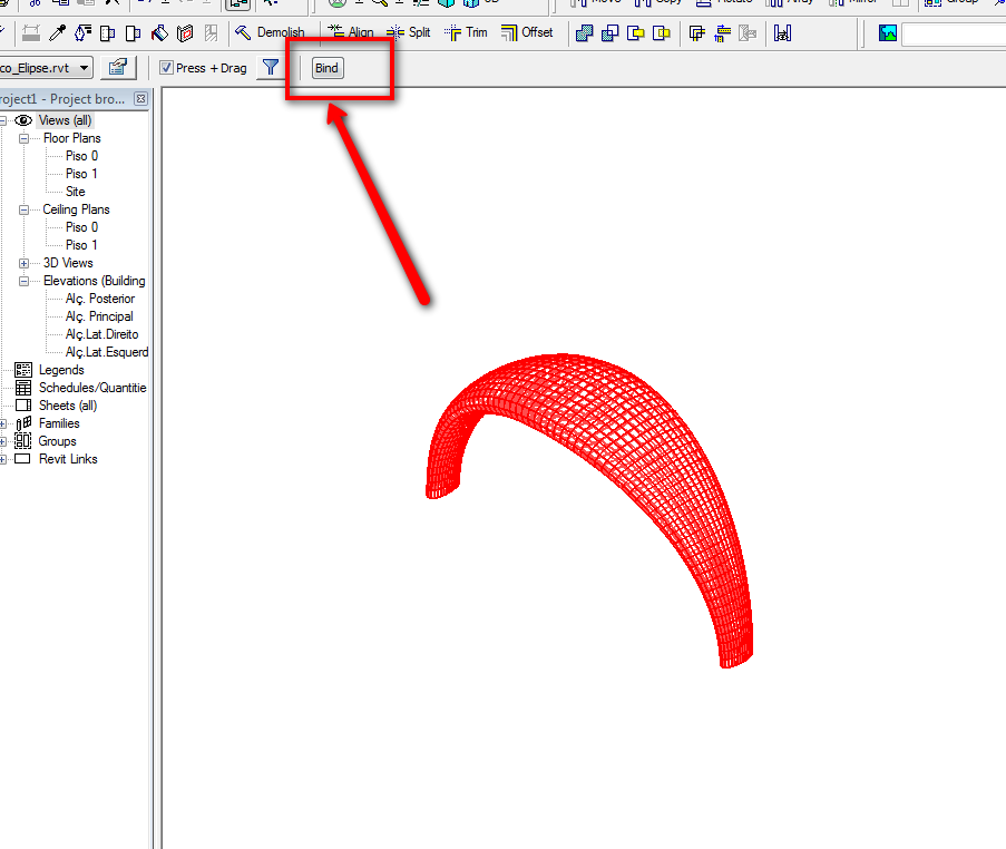

What version of Revit are you working???
 See the images attached....
