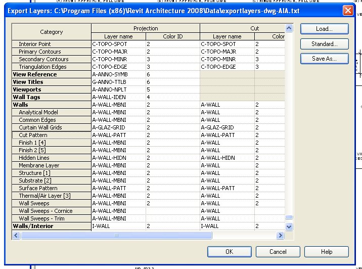

I am currently trying to set up the dwg export settings.  I cant seem to find a catagory for filled regions.  I want to set the line color for a filled region pattern.
My real issue is that when I export a rather dense filled region from Revit and open it in AutoCAD and print, it becomes one solid patch.  I need to be able to set the line weight of the hatch out of Revit if possible!
Can someone assit me in this?
Nic

In AutoCAD have a line type in mind that is set to print very light.
In Revit go to File > Import/Export Settings > Export Layers DWG/DXF
Look for the coorisponding item for wall cut patterns and change the color of line to what you want in AutoCAD
See image for what the dialogue looks like.
Hope this helps.
