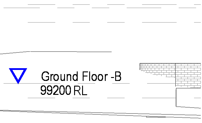

How do I fix the RL lable in elevation? Revit defults on right hand side, but when I switch it to left hand side in elevation/section. PS I am using V7.

Thanks for your help guys but I think I will clarify my problem. at the moment the level right hand side (defult) reads: First Floor RL 00.00 but when I switch it to left hand side, it reads First Floor 00.00 RL obously the variable being the level & floor level but RL is a constant, it is the position when I switch to left hand side the RL letters appear after the variable level ie; 100.00 RL Help please Thanks

Okay I get you now, You'll need to create another level head for the left hand side. Open the appropriate level head family and shift the RL to be where you want it to be in relation to the elevation label. You will probably have to slide the elevation label over as well. Save with a different name. Then load this back into the project. Select one of your levels with the left aligned text, goto properties--> Edit/New-->Duplicate then give a name and change the level head to your new amended level head with the bubble default at the appropriate side. HTH.
