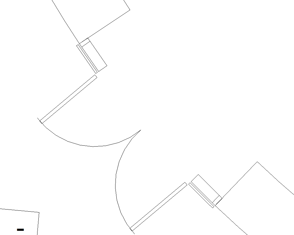

I have created a curtainwall system with a pair of doors.  I can not get the curtainwall to align properly, it is sitting half in the wall and half out of the wall.  I can adjust the offset for the frames and get them correct but then I can not get the glass adjusted.  See the attached image.  PLEASE HELP!!!

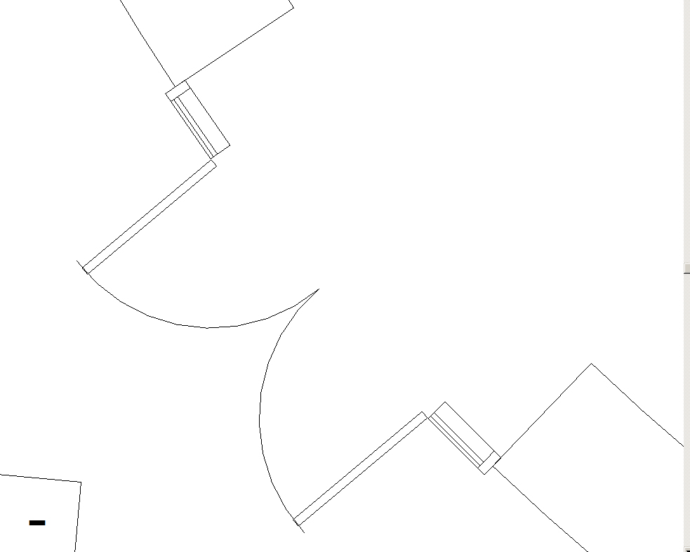

Sorry I forgot to attached the second image, this one shows where I have adjusted the frame offset but then my glass sits outside the frames...Thanks again Smile

You need to set the offset for the Panel. To do this you will need to select just the panel (hit tab until it is highlited) and go to properties. There is a parameter for "Panel Offset" in the type parameters for the panel. Adjust this value as necessary to get the panels to align the way you need.
Tue, Mar 11, 2008 at 3:01:57 PM | Aligning Face of Curtainwall w/ Face of Wall
JOYSMIDNIGHT
Joined: Fri, Mar 4, 2005
30 Posts
3 Stars: 1 Votes
I know it was in there somewhere, I just couldn't put my hands on it.  It's been over a year now since I touched Revit.  Thanks again for your help!
