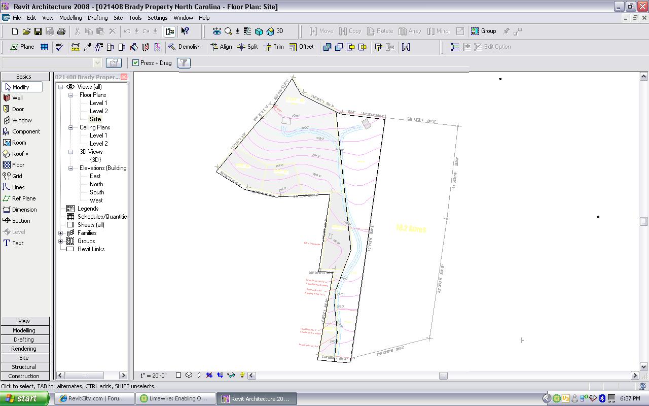

Im working on a project that it requires from me to recreate the site where im gonna locate 2 new buildings, as you can see in the attached picture, the size its farely big and it have several contour lines with different types of elevations, when im drafting the terrain i got an issue because i can pass out the 200' feet elevation... i dont know why..
 im using intervals of 20' increment at each contour line and when i reach the 200' i cant keep going up...
does anyone knows how can i fix this..?
Thanks!

Hi Julio, if i figure what your problem it's simple, go to "SETTINGS > SETTINGS-SITE" then you have a "Start" and "Stop" contours, in "Start" put "0" in "Stop" put "300 or 400" then "aplly and ok" then your contours will appears. Are you Spanish or Portuguese?

"SETTINGS > SITE-SETTINGS", sorry....

Well thank you im gonna apply that and i will let you know the results, Im sorry for the delay in the answer its just that i went away for a couple of weeks to my country... im spanish im from Caracas, Venezuela... but im currently studying in college here in the USA.
 As i said im gonna try to set the site using the instructions that you wrote above if i have any issue ill be replying back soon
