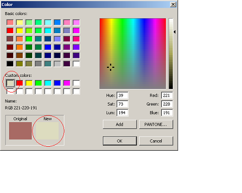

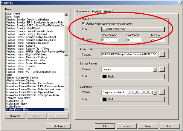

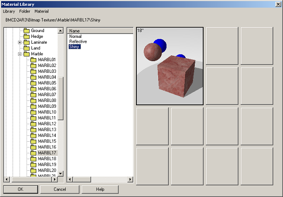

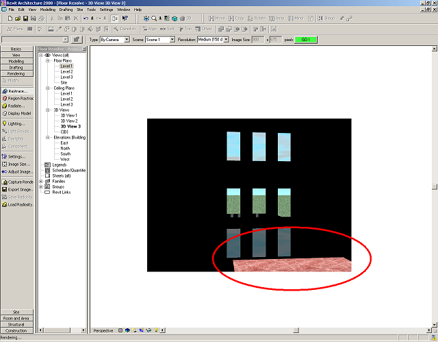

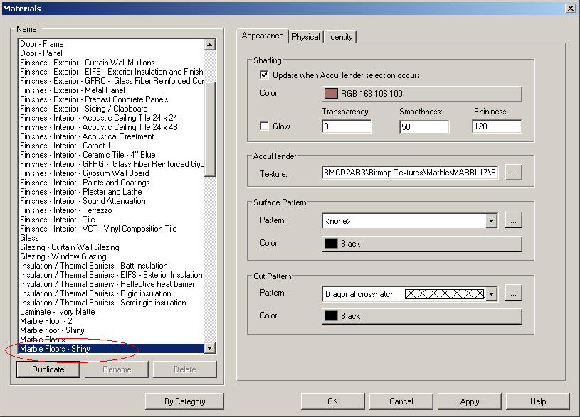

I have attached images to help explain:
I have a material/texture I want to use, but I want to change the color on it...and I do.
When I render, the old color shows up and the new color doesn't. Not too sure how to go about fixing this.
ANY help is appreciated.
Thanks,
Jimmy

The part of the dialog you have circle defines the shaded color of item, not the rendered color. The material you are showing has an Accurender Texture applied. This will define the "Color" of the item in Renderings. You will need to actually modify the Accurender Material to get this to change.
