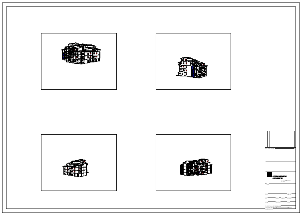

Dear anyone I would like some help in changing the size of the image once you have set out your perspective view, mine seem to come out too small fo my liking

When placing on a sheet, Select the view, there should be a size button at the top. Click this, then make sure you tick scale and change the view to what you require. HTH.

Thanks
