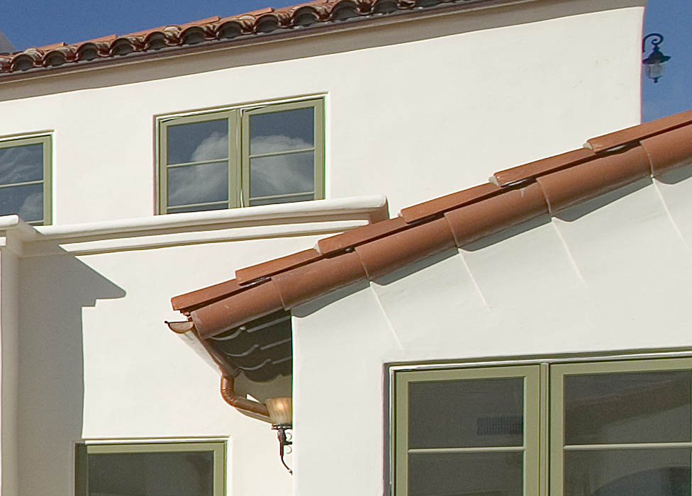

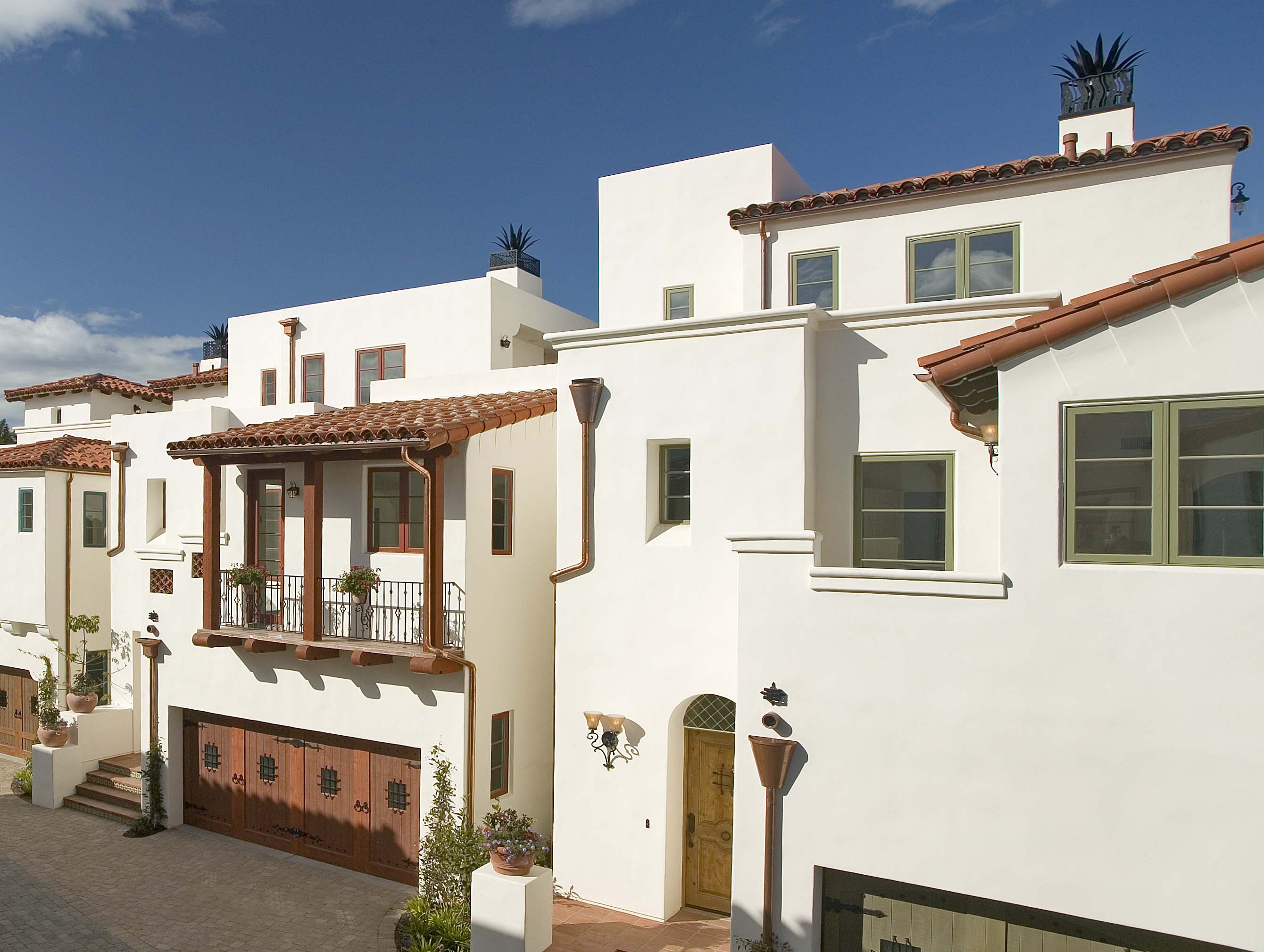

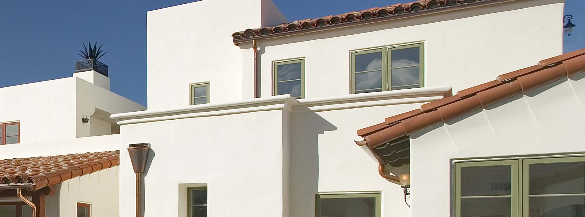

Im working on a remodel of a house. On the gable ends i am trying to create the same look as the photos of one of our other project. This project was done on CAD before our office switched over to REVIT. If anyone has any suggestions or ideas on how i can get my project to look like that, it would be much appreciated. also, can someone suggest a way of creating the spanish tiles.

The simple way to model those tiles would be as a curved fascia with a vertical surface pattern.
The complex way would be to create a tile compnent and aray it along the edge of the roof, locking the first and last component so it sticks with the pitch.
