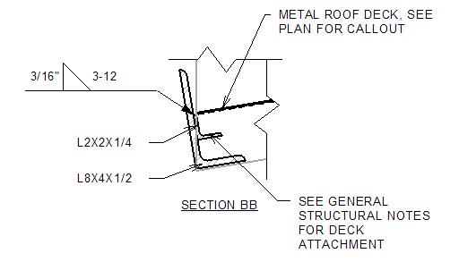

I'm having a visibility problem with my sloped metal deck (1 1/2" structural metal deck) as shown in a section view.  When the section is cut parallel to the span of the deck, I can only see the lines representing the top of the deck rather than seeing lines representing both the top and bottom of the deck,.  I've tried changing all of my visibility settings to no avail.  I don't have this problem in section views where the same 1 1/2" deck is flat; both to top and bottom of the deck are visible.  Has anyone else ran into this problem?  Any ideas?  I have attached a small section view showing the missing bottom lines of the metal deck.
