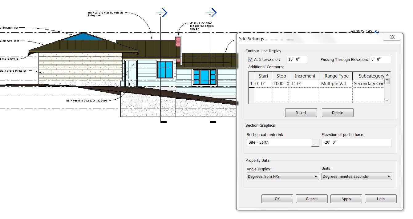

Does anyone know how to make a topo surface project deeper?  I need it to cover the footings in elevation and section.  I tried adding another to the bottom and it didn't merge correctly.  The topo lines stop at -9' but I need the topo to fill to -20'.  I'd rather not have to modify every section and elevation with a filled region.
 See the attached image for a look at the issue
Wed, Feb 27, 2008 at 12:14:44 PM | topo depth
Settings \ topo settings - elevation of poche base
Wed, Feb 27, 2008 at 1:11:17 PM | topo depth
lbrooksher
Joined: Tue, Oct 16, 2007
16 Posts
Yeah!!!  Thank you.  I never would have guessed that one!

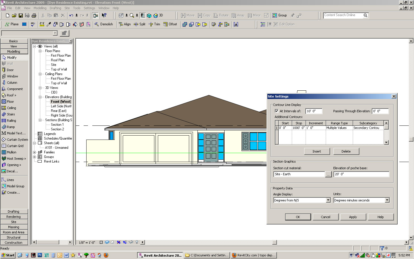

I know this post is old, but Ive just come across it in a search, and now Ive changed my depth of my topo and it still shows it as thin. is there something Im missing. revit 2009.

Just to clarify this for future readers, I see that we all missed Warchitect's problem.  If you look at the image Warchect provided, you will see that he has the poche base starting at 20'.  There will be no poche if the elevation is above the site level which probably was 0'.  If you want the poche to start below 0, then enter a negative number.

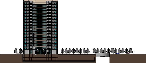

Please see attached file. I would like to have the earth cut down to the bottom of the foundation, which is 35'-0" below Level 1.
The way I did was to have two toposurfaces, one for the building which followed the building footprint; another for the rest of the site. Any suggestions? If I had a complicated basement layout with different depthes, that would have multiple toposurfaces.

Read your HELP about PADS.

Thanks! Please see attached file. First, how to change the Pad to not shaded in "Shaded",  "Consistent Colors", or "Realistic" view?
Second, please help to to solve the colors for the earth, earth showed blue for the site, brown underneath the pad, they are in the same toposurface.
Thanks in advance!
Wed, Nov 7, 2012 at 1:55:29 PM | topo depth
#14
Your settigs - not enough information.
Wos blue - interesting color
Is the brown your pad?  Did you set its material?
A PAD only cuts a topo to the bottom of the PAD.  What you show is not that so you have done something else.
