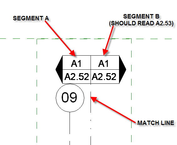

So I am finally working an a building that will be segments onto multiple sheets and I would like to use the view reference to show what sheet the adjacent segments are on. But everytime that I place them they all point to the same sheet.
How do I get 2 adjacent View References to reference different views and show up on multiple views? Basically I want something like what is attached but functional.
Thanks
Nick

I totaly missed this before, but there is a "Target View" menu where you can choose your target view. At least this works for dependant views, but I'm not sure where else you would use view refences.
