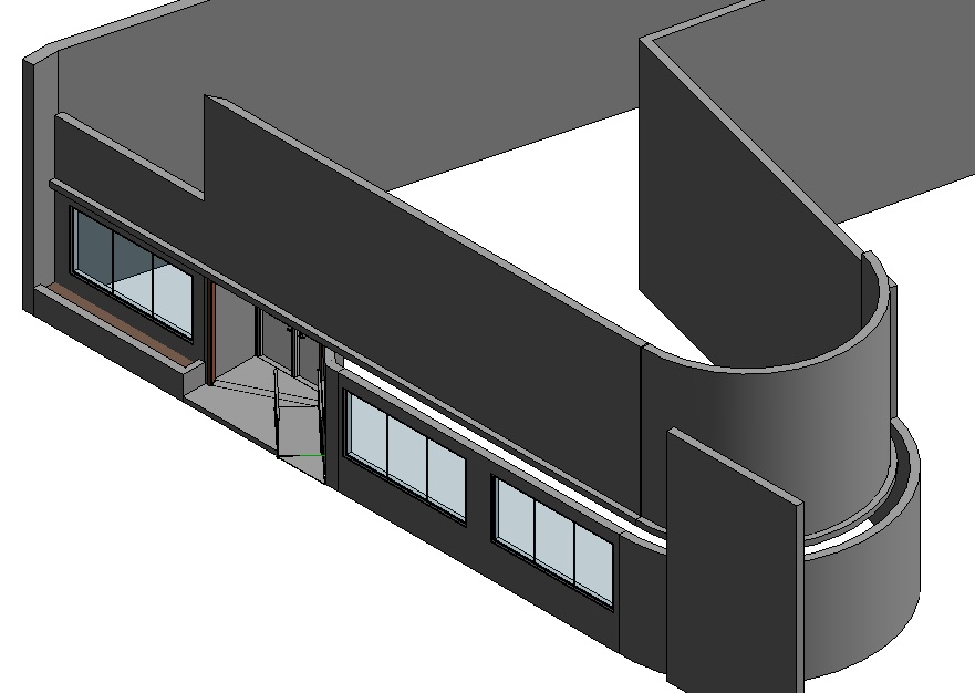

How can I make a flat 2 foot x 6 inch profile with a curve on the outer edge to attach to a curved wall?  Should I be looking at wall sweeps, or is there an easier way?

Not sure what the image shows us.
A wall sweep as part of the wall definition, will follow the wall.  That requires a profile done in a profile family.  An applied wall sweep will also follow the wall.
An in-place sweep can also follow the wall.  You can sketch the profile for an in-place wall sweep from within the project.
