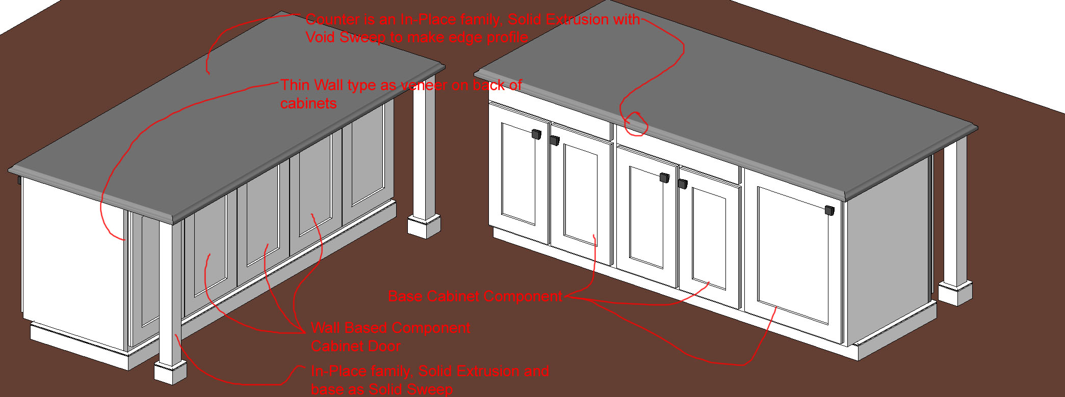

2) Island-- how would i make a large kitchen island .

 As far as the island is concerned, you would make it the same way you would in realality.  Insert base cabinets. It could be base cabinets back to back, but more often the back is a series of panels resembling doors or bead board.  In either case, you would want to make a wall type that has a finish of wood veneer.  If you want to apply panels, you will need to find or create a face-based family that is just a cabinet door.  You can then sweep a base profile around the bottom.  For the counter, it probably would be easiest to just draw an in-place family and make an extruded solid.  If the counter is to have a shaped edge, you will need to do a void sweep around the edge.
I need this kitchen island i found rezied to fit in the kitchen..help plz
