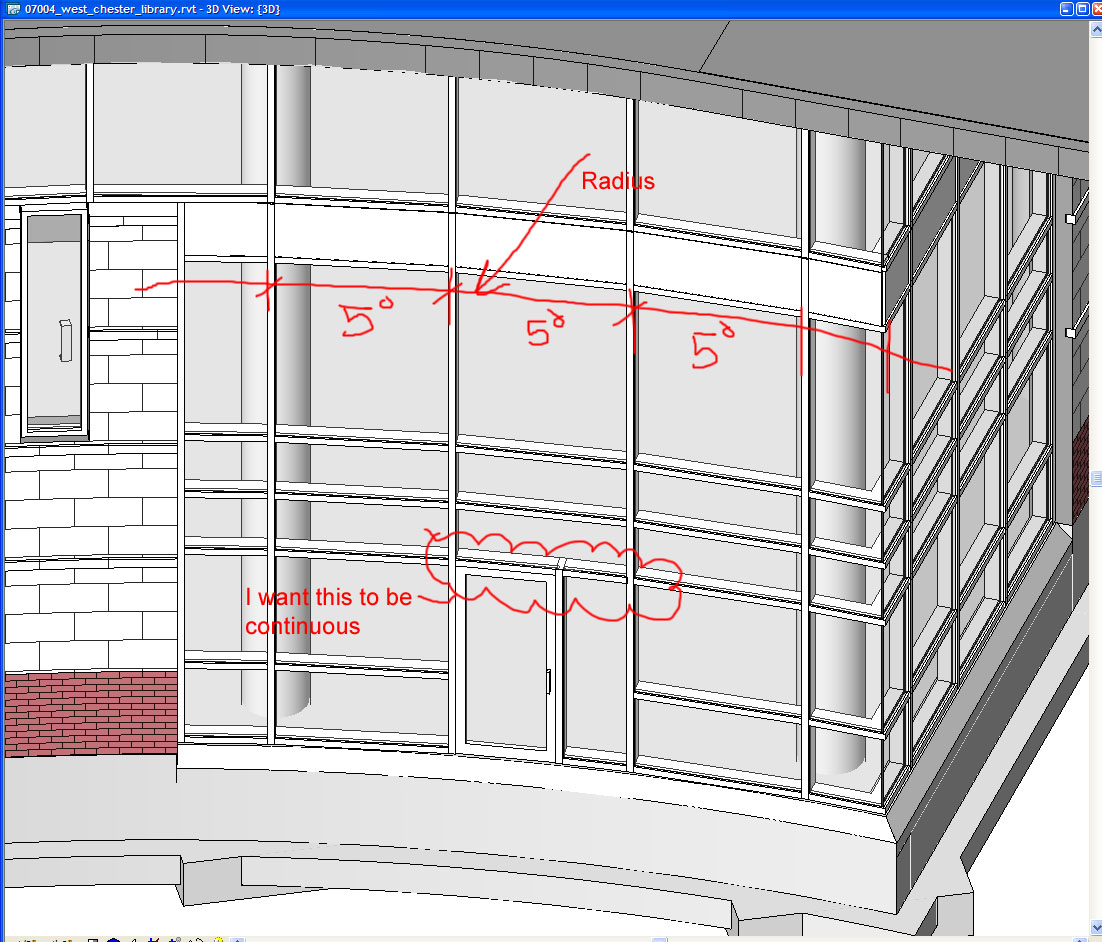

I have a curtainwall that was drawn as a curve and then vertical grids were inserted.  I want to add a single segment to divide a panel in two so I can have a door and then a lite to one side.  when I insert the single segment, it folds breaks the horizontal mullion and bends at an angle at the segment.  I dont want to have the fold.  Is there an easy way to do this?  I know that I could define a new door type as a panel and in lieu of inserting a grid, I could have a door that has a mullion at the jamb and then a side lite, but I was hoping there would be an easier way.

Select one or both of the transomes over the door, right click your mouse,>join conditions>make continuos.

I have done that and it makes it cintinue over the horizontal mullion, but the horizontal mullion still bends at the vertical mullion.
