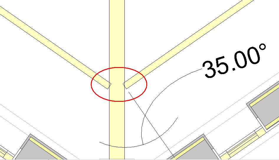

I have a problem with my beams. i dont know how to make them be cutted in the appropiate angle that i need.
Im attaching 2 images so you can visualize my concern
In the picture u can see that the element that is in the center is a girder sitting over a concrete pilaster or column.
what i need to be able to do is: make the beam touch the girder completely and be cutted in the 35 degree angle
I have the same issue in others structural elements in this building cause its angle.
The 2nd Image shows a 2 pices of a sillplate that i need them to be touching together with the appropiate angle cut.
Perphaps im not using the rigth tool or i dont know the appropiate command, can somebody help me please....

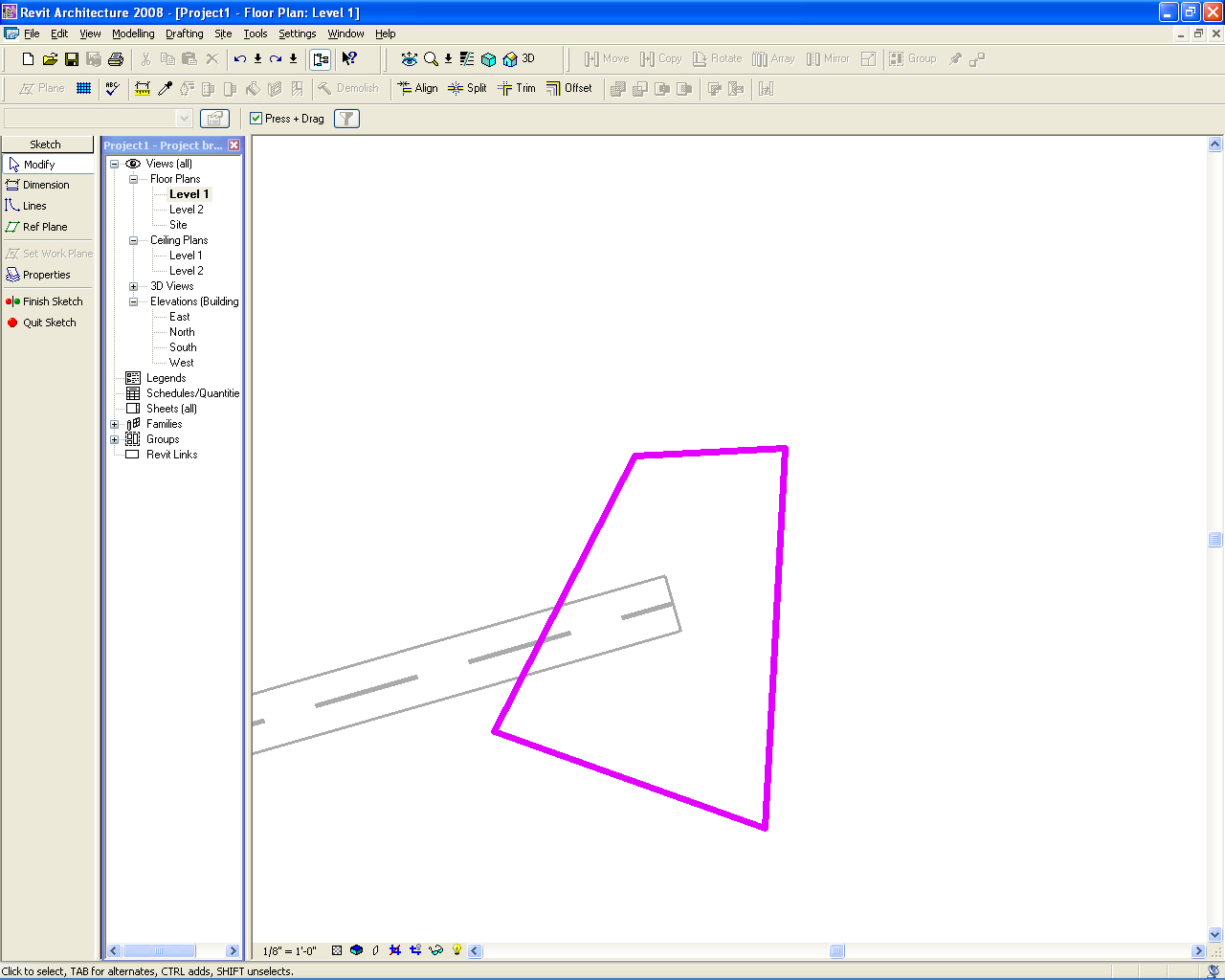

To cut the beam is actually pretty simple. What you need to do is go into the framing plan and draw the beams how you had them in your second picture. Then what you will want to do is go to the modeling design bar and choose the opening tool. From the flyout choose opening by face. Move your cursor over the beam in a plan and you sould see a green box appear around the beam. Let click and this will bring yo uinto sketch mode. From there all you need to do is draw around the area that you want to cut away. This does work in RAC as well as RST.
I attached a pic of what the sketch is like.

 The Opening By Face Tool work out pretty nice for me .... thank you i really appreciatte that....
now i got the beams and the sill plates cut with appropiate angle that i need.... thanks brentt.. and thank you for the file john.....

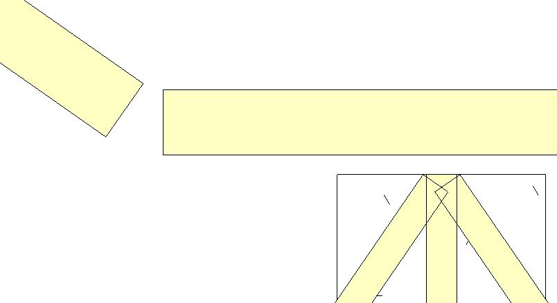

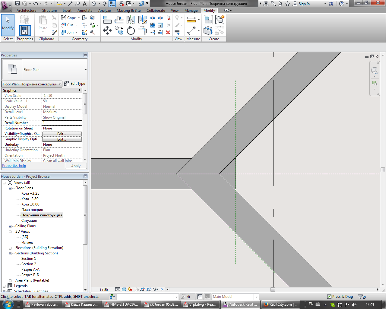

Hello everybody, someone could still read this ... What I found to work for me is:
Create reference planes where you need to cut the beams and use Modify/Geometry/Cut Tool.
Select the beam you want to be cut and then select the reference plane. However you can't delete the reference planes because the cut will disapear.
You may have to extend the beams a little in order to cross them with the reference planes.
Good luck!
