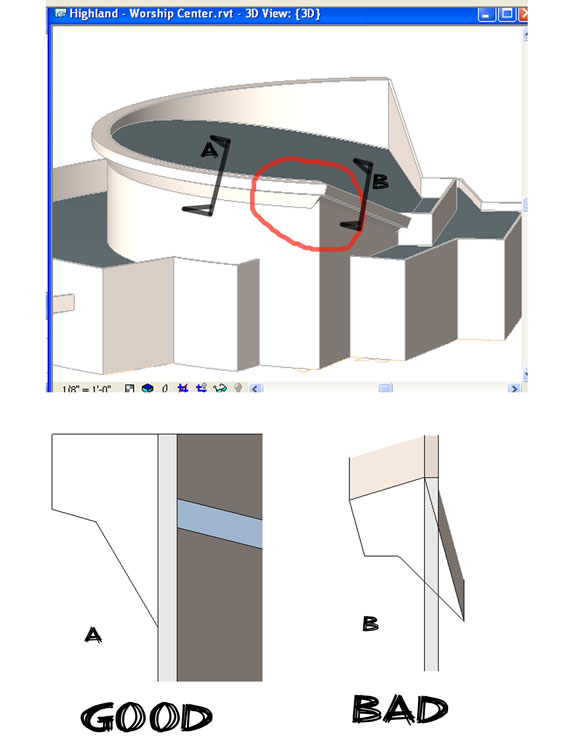

Im trying to put this sweep trim on the wall as shown in the pic attached. the profile changes angle as it turns the corner and goes down. this is undesirable.....how can i keep it flat to the wall?

I had a related issue, but it was not a curved surface. I was able to fix it by doing the sweep as multiple entities and joining the geometry. This may not work in your case because of the curved surface, but it might be worth a try. I am not sure why the sweep does this, but it can be very annoying. I hope you get your issue figured out. Good Luck!

I fugured it out.....
FYI.....

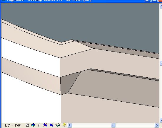

I had to jog the sloped wall over alittle to allow for the thick sweep profile to fit and turn down.... see the pic...
