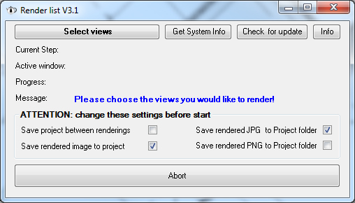

Here are the screenshots as reguested. I'm using an English version of 2014.
I just tried it again at Draft settings and your addin is saving the renders as it should. (Allthough the short filenames are appearing in the dialogs) Strange.

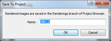

can you please try if it works when you uncheck "save to project"? i think that this is the module that is causing problems.

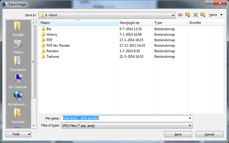

When I hit Shift+X the save image dialog appears. (As it should I presume?)

yes thats fine.. is the textbox empty?

Not empty...see screenshot.

sorry my fault.. its SHIFT+V

It's not empty... See screenshot. Should it be?

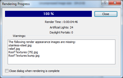

Last night I retried to render 11 views. This morning only a part of the first view was rendered.
The region selection box was checked so only a small part of my view was rendered and the processbar showed 100%. The autoclose checkbox was not checked so it was waiting for me.
Can you fix this?
See screenshot

try changing the name of your views, the -3D- part is incorrect. You cannot save files in windows with a dash. Change it to 3D.

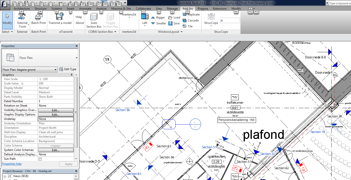

hi there one question i really like yuor script , but the problem is i never used apps for revit and i dont know how to make the external tools button apper, i dont have it on my add in tab . i installed one addin like 5 min ago, so to see if at least one randmod addin works
and it does , but i still cant get the external tool or make the batch render scrit button to show
im using win 7 64 bits , instaled net frame work 4.51 put the file in C and the addin  file in revit , even if my directory path to revit  is diferent its program file autodesk revit 2015 addins
so can yolu please help me, how do i get the external tools button to show up , i need to make like 50 renders and its imposible to achive whitout a batch like yuors, thx
