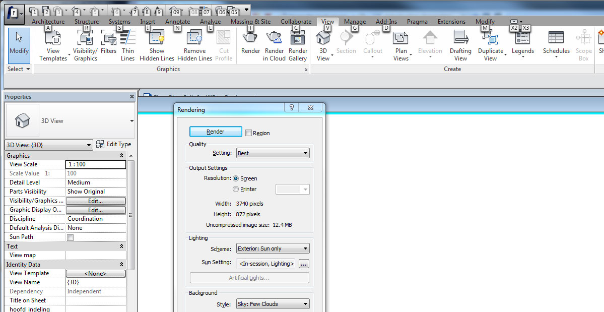

Here are the images requested. I hope you can fix it....

thanks! looking into it. could you please tell me what of the 4 checkboxes is causing the program to stall? when it saves the image to the project, when it saves it as jpg, or when it is saving the whole project?

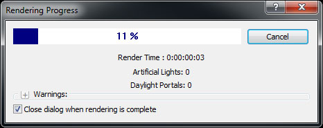

also could you please post a screenshot of the stalled app so i see what it is expecting? thanks!

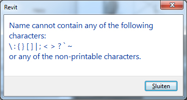

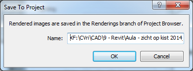

I've got a new issue with your add-in.
Last night I tried to render 11 views. This morning when I looked at my computer only one view was rendered and the following message had popped up:
It seems like your add-in wants to save te whole file path wich revit doesn't allow to do. When I removed the path from the suggested filename in de dialogbox It did save the rendered image.
Any clue?

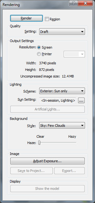

could you please post 2 screenshots:
1 of the plugin with all the settins the same as when you had the above error,
1 of revit, but before you take the screenshot hit the ALT button to show all keyboard shortcuts.
you are on the english version, right?
i cant do it myself because i am on the 2015 version.
