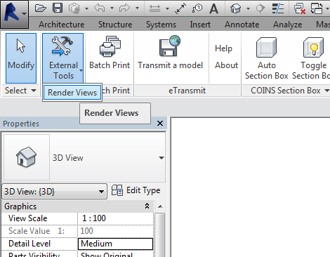

did you get a chance to select the views to render?
>>No. It seems it doesn't respond to my clicking at all. No dialog is shown.
do you have some 3D views ready?
>>Offcourse, a lot of them. Allthough when I'm in a 3D render view the menu option 'render views' is greyed out. It is only possible to select the command from al pllan view.
did you install .net framework 4.5?
>>Offcourse. It comes with revit 2014
whats the language of your revit?
>>English.
is the text "render views" grayed out?
>>Not when I'm in a 2D view. (see the attached screenshot)
also keep an eye on the BLUE text as it tells you what you have to do.
>>Blue text? I can't find any blue text. Should it be in the status bar?

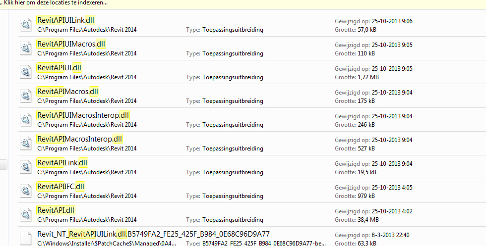

Thu, May 15, 2014 at 6:46:34 AM | Render list of views
#58
RVANL
Joined: Thu, May 31, 2012
0 Posts
These files are present. See the attached screenshot.
