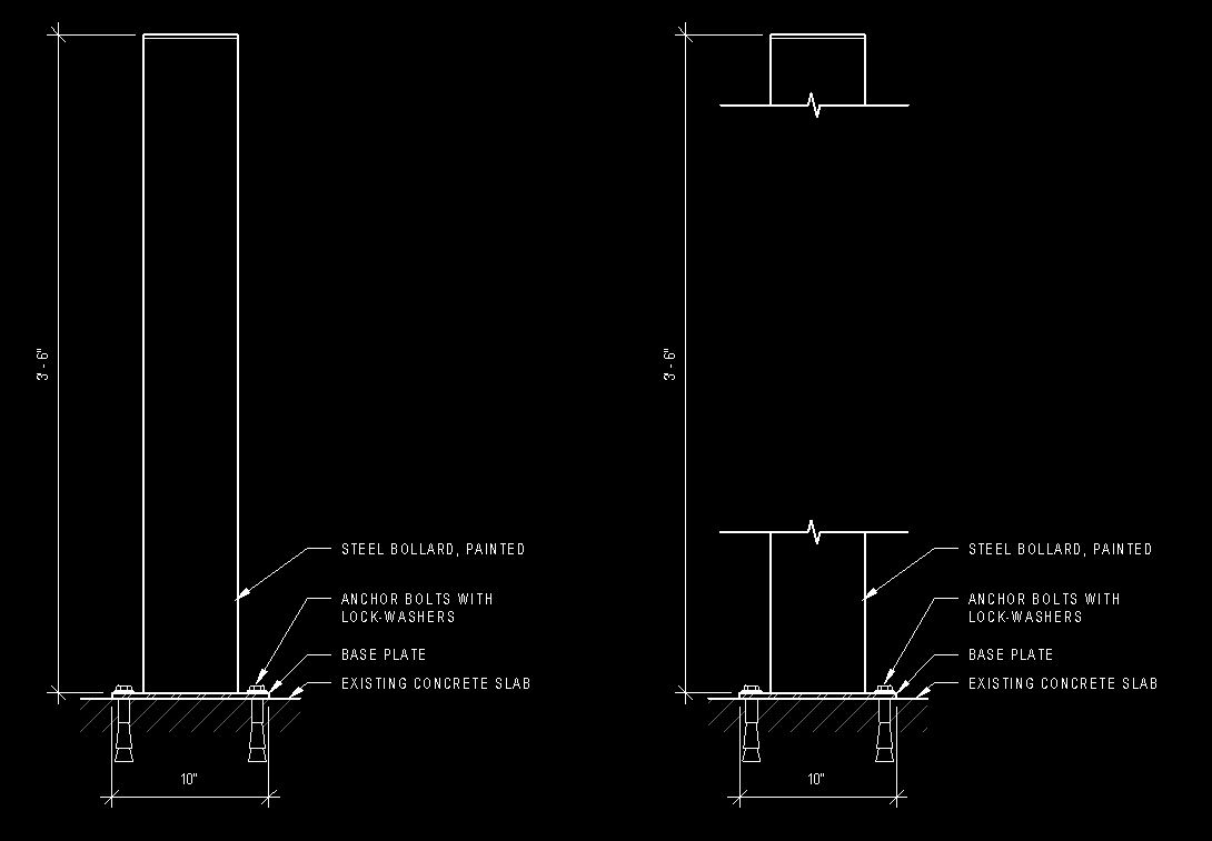

           Thank you for clarifying, sometimes it's difficult to catch the correct intention of someones typed words.  I do aggree with you on keeping things "Smart", but how do you correctly dimension the breakline drafted detail?  My problem is I have to show the 5'-0" depth of the foundation for the bollard and the 4'-0" height of the steel pipe.  my break lines afford me the ability to show approx 2'-0" above and below grade, but when I go to dimension I can't show the correct dimension. Now I have to mask over the dim, add text, etc...  At that point I may as well have placed a bollard family, cut a section and jazzed it up.  Maybe I'm just being thickheaded?
Tue, Aug 27, 2013 at 12:39:30 PM | Crop Region in Drafting View
#42
I don't like fake dimensions but there are ways to do this.  The first is all dumb.  Do a model view with a split window and freeze it into a drafting view.  The problem is, everything now is primatives - including your dimensions.
In this blog is a smart solution (but I don't even let our staff here it here.)
http://lineshapespace.com/revit-dimensions-more-than-meets-the-eye-part-2/?goback=.gde_68075_member_263532100
I hate fake dimensions.  I got burned so many times in CAD by people that just changed a dimension - and there is no way to know it!  I loved the fact that initially, you could never really over-ride a Revit dimension but this does.  At least when you click on this in Revit, you will see it is an over-ride.

I did a search on crop regions and splitting views and arrived at this thread online.  Attached is a detail of a traffic bollard.  One side shows how the drafting view detail is really tall.  I don't need it to be this tall.  I'd love to split the view and drag the top of the bollard down using my break lines and keep the dimension of 3'-6" without having to fake or cheat on the dimension.  This isn't an unreasonable request for Autodesk to provide a split-view tool in drafting views.
