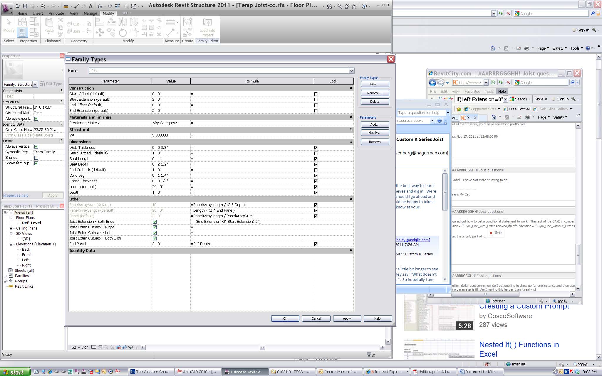

OK - now i drew in four symbolic line like you suggested and I labeled each one of them as a parameter.  (below are the parameters in the "Other" category - but what is the box with the check mark in the value category?  I checked my books and can not find it)
Now all I need to do is figure out how to write the formula for each line.  Every time I try one it comes up with a message that I can not do it.

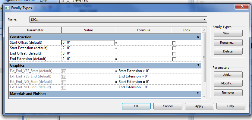

Got it!  Assign a visibility parameter to each of the 4 lines.  Then create a formula for each of the visibility parameters.  See the attachment for the formulas.  Works like a charm based on the Extension Dimension.

Can I ask what are the boxes with the check marks under value - what do they represent?

1 Stars: 1 Votes
Yea, those boxes are based on the value of the Start Extension and the End Extension.  In the example that I uploaded, both of those are set to 2'-0", which is of course greater than 0, so the forumla causes the boxes to be checked.
If the forumla is TRUE, then it checks the box (makes visible).  If the formula is FALSE, then it unchecks the box.
