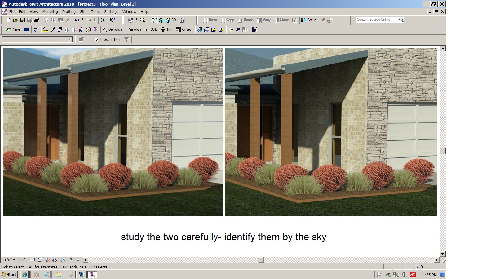

good work table-
see the image..

the picture on the right looks so real i can imagine
someone actually walking around those bushes
and in that walkway.. the one on the left looks
worse than a fake magazine picture..

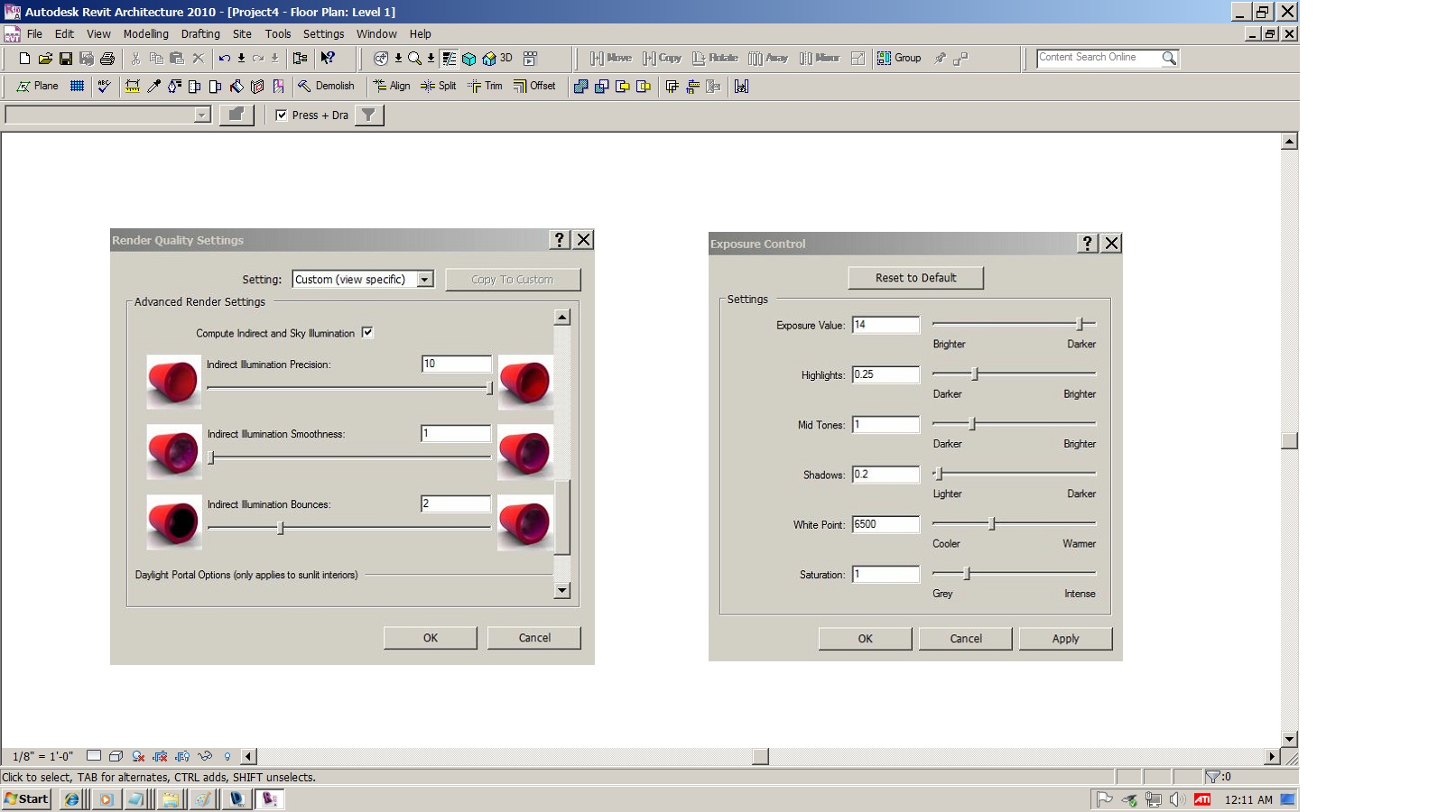

okay table listen to this:
this all boils down to the bounce or the no bounce
option.. depending on the scene- sometimes the
2 bounce option looks better than the 1.. with the 1
bounce you need to lighten of the shadows like i said..
with the 2 bounce you "reset" the exposure dialog to
default..
for the most part the 2 bounces looks a little more
UNNATURAL.. think about that.. to calculate light is hard
enough- but to calculate it bouncing all over the place
is near impossible.. but on the other hand- that extra
bounce fills in the dark shadow areas and MAY look
better..  so try the same render with the 2 bounces
and the exposure set to "reset default"..

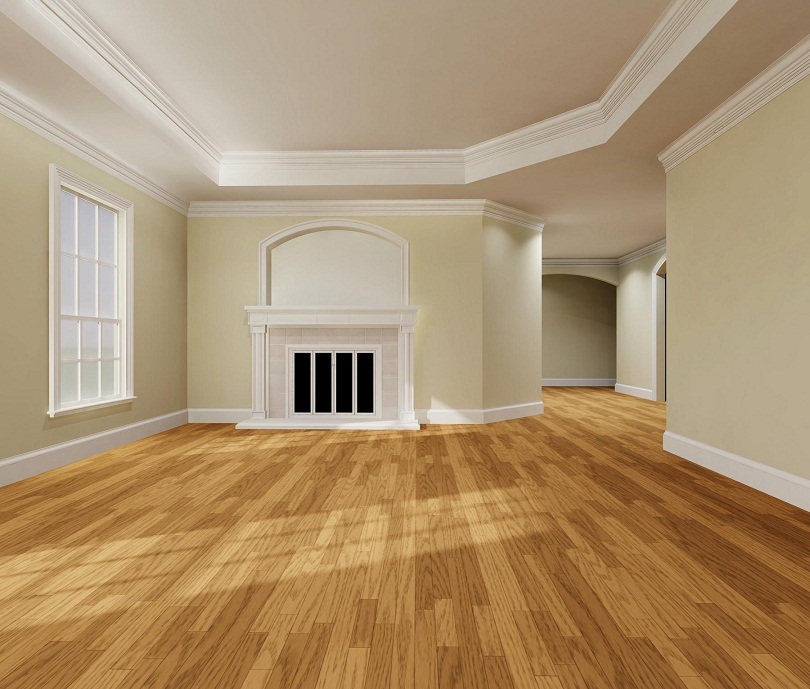

Interior rendering is a serious art.. if you look at a lot
of professional interiors you will see lots of light bounces
and relections and minipulation of light.. but i think just
simple interiors are fine for just selling something like
a house design.. here is an example of a simple
interior without a lot of light manipulation and
interior decorating and furniture..

table- but you need to know that even though
i told you about being able to use 2 bounces- i
will never do it.. it's just way too unnatural for me..
so the first way you did it with all the settings i
gave you- that is the best way in my opinion..
