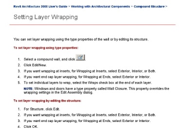

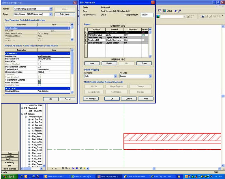

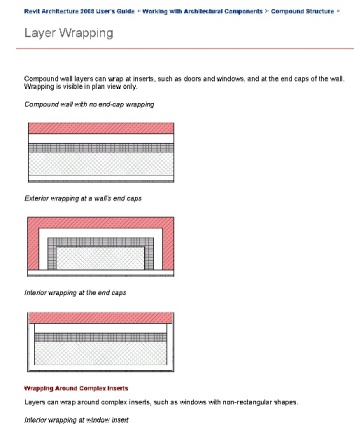

Ok, I have attached the relevant sections from the Revit Help Users Guide and a screen shot to show how we have all the settings as per the instructions, however the wall layers are not wrapping at the ends of the wall. The screen shot is a plan view and we have tried various options to get this to work and are yet to achieve.
Hope this makes a little more sense. Thanks

Actually, please disregard that last question. I just realised I didn't have an internal finish on the wall and once added it is working fine. Sorry about that.
