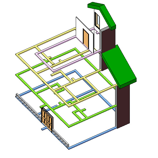

I have used Default wall and I have used different colors for it - one color for each floorplan. That´s it!
You have to first take in the images for the different plans and then use walls with just a little height.The walls for all the plans - you then in another file takes in with File > import/link > RVT - origin to origin.
The images will not being imported.And you can see the plans both in 2D and 3D in the new file.
And something you have linked is not so irritating as groups. And if you happen to select the plan you can easyclick outside to unselect - that is not possible using images of plans because you have to zoom out first soyou can click outside the image to unselect it.
Having a large project I believe this is a way to understand better... how everything has to be constructed. I have not tested yet. This is just an idea.
Have a look at the image and I believe you can understand. Door, Roof, Brickwalls are in a file I have namned house.rvt. The plans with its small height walls in different colors are in a linked file I have namned houseplans.rvt.
Hope you have got my method. You can have a try! And say what you think.

You did not say anything about my idea with a linked plan file for design also in 3D not being annoyed of images with plans - you only can pin - not make unselectable. Hope you will have a try with my idea!

You did not say anything about my idea of working in 3D with a linked file showing the plan.

I don't see the point?  You've already done all the work creating these linked views?  How does this improve your workflow.  You've added an extra step by making yourself redo the work twice.  Maybe I'm misunderstanding?

To make a plan to link to and you can work in 3D with plans in Revit makes it easier to see what you are working with - having a large project - you do not need to go between the levels - you have always a skeleton with walls with tiny wall heigts to refer to in the 3D view. And a linked file with the plans are not so irritating as groups. It is not unselectable but is hard to select and easy to unselect!!!
Smile
It would be possible for Revit programmers to let us see transparent images of plans in the 3D view - being unselectable. But that is not possible for the 2008 version as far as I have understood. Someday?
Smile
I believe my idea is great - you can get an overview in 3D space - now Revit has got a transparent command - but not the way to show hidden things as ghost images as in Sketchup - also being able to hide the ghostobjects(the hidden things). I believe my idea is good - Sketchup ghost objects gives a lot of clutter. And you do not have to wait on some programmers to implent my idea - you can do it yourself!!! And you can filter the 3D view taking away eg all the walls and still you can see the plans and you can orient yourself in the building still. Have a try yourself - perhaps you will like it!
