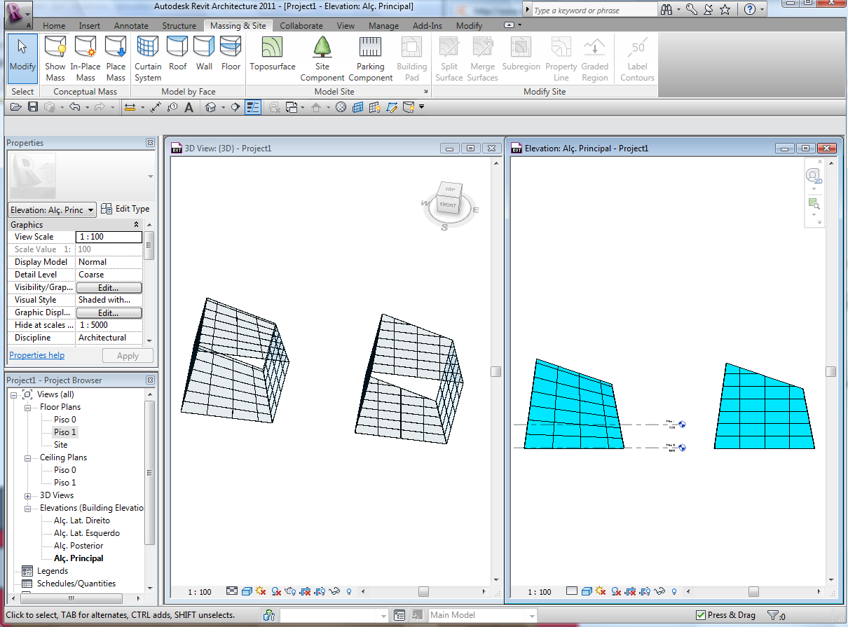

To VersionX:
What are you trying to do is what i have In my image? in right side?

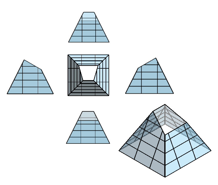

Use the truncated pyramid mass, which is already included in the Mass folder. Apply curtain systems to the faces, done.
