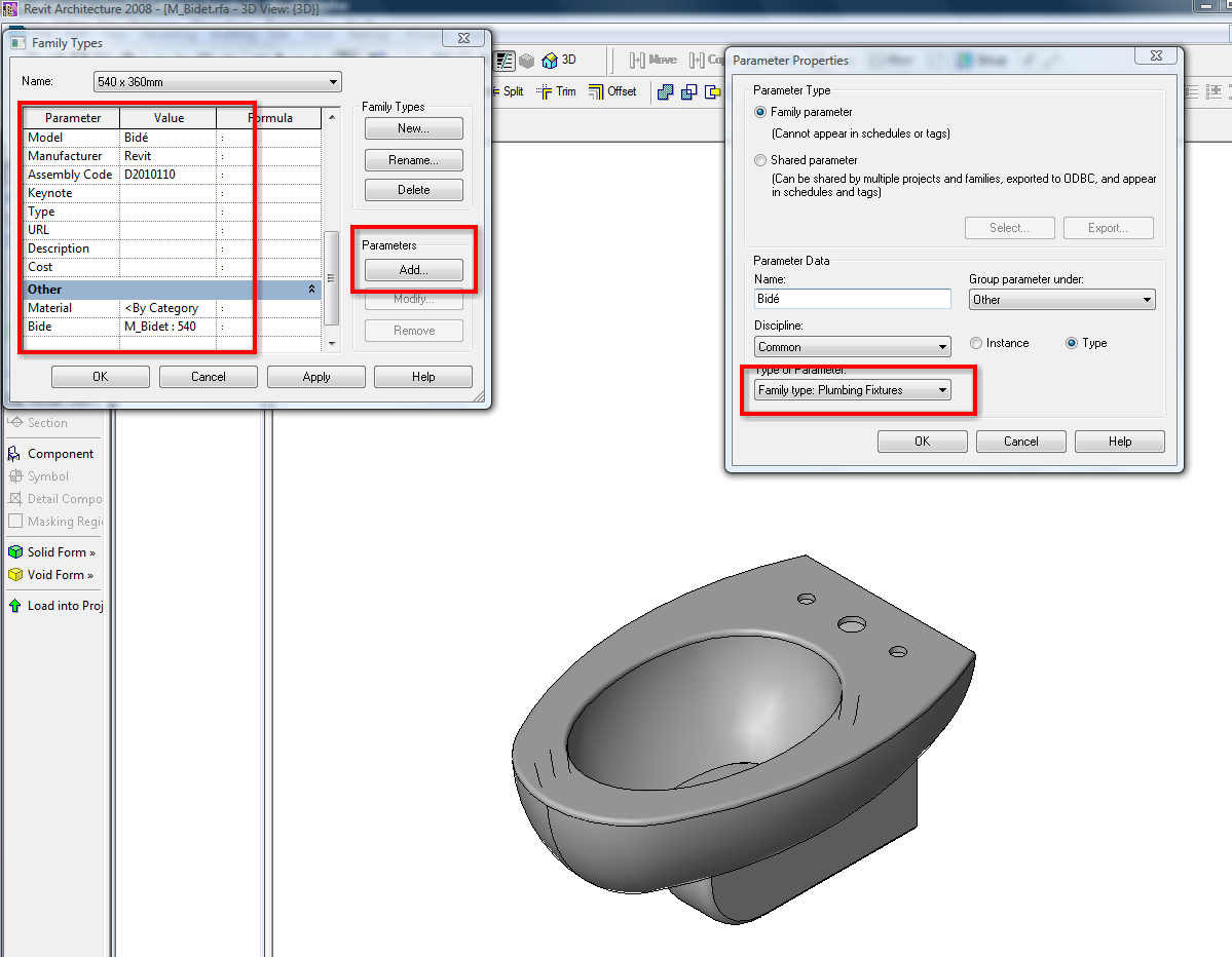

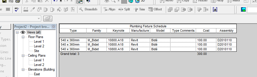

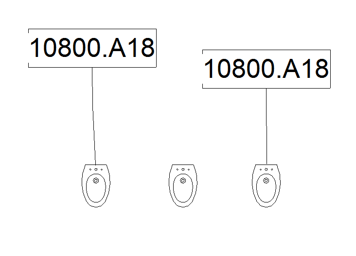

Dprado, sorry but you don't have a point, when you says "i'm new to Revit and i have no clue what identity parameter is or how to do it?" he answered "That's why you go to your help menu first.... you need some fundametal knowledge first." so  you must go to the Help menu or the tutorials and try to find out what do you need, "As a teacher or someone who is helping - you should know better -for a new user to be attempt to learn the language of Revit is hard" well, he's not a teacher and this is not a classroom, he is only one person who try to help (if he could) in this site, but there are some many people and some many questions and we have our work too, we do this because we want, no one pays us, like you said "when just starting to use the program its hard "Master" so that's one reason to check the Help and/or Tutorial.
see the images, i hope this can help you...
