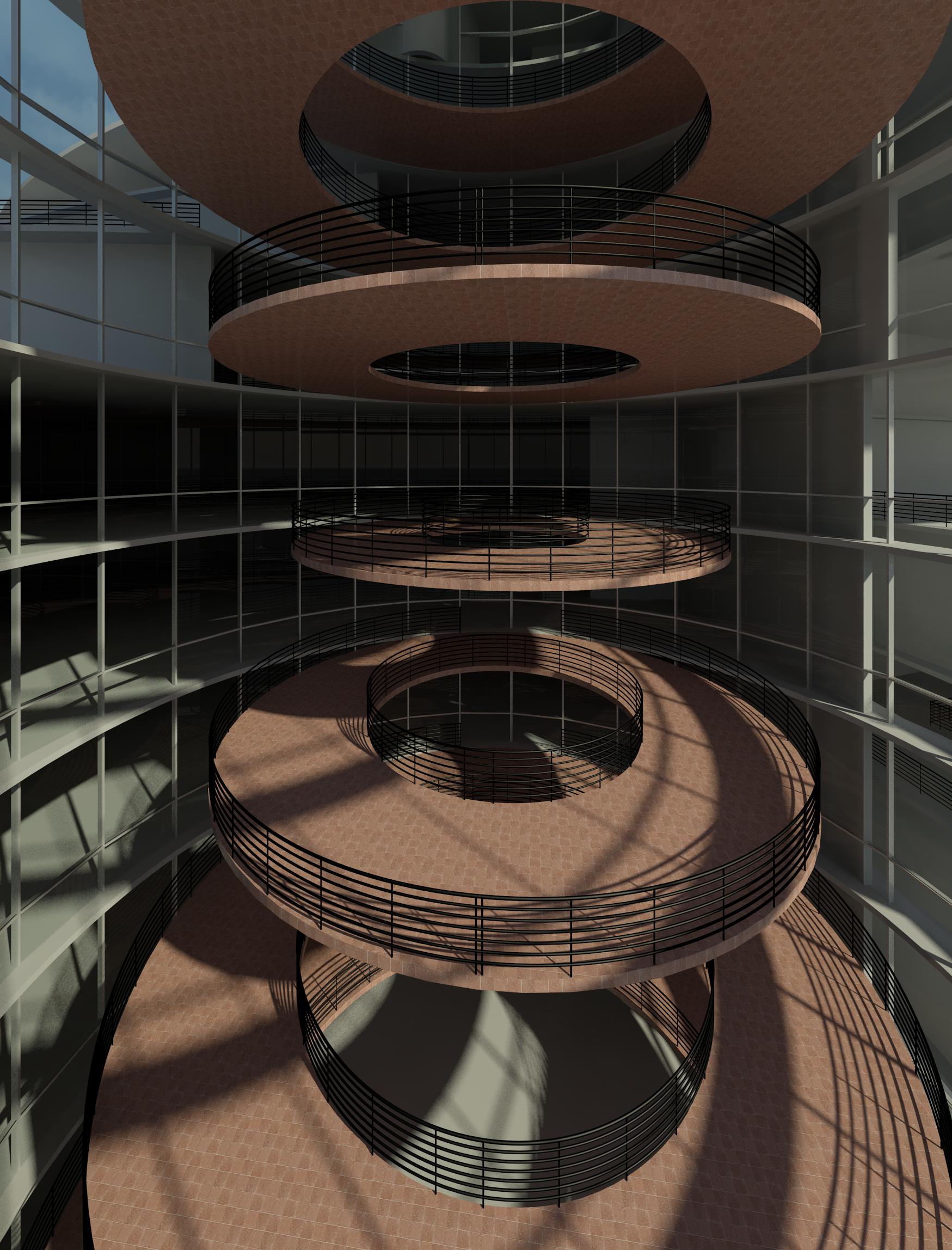

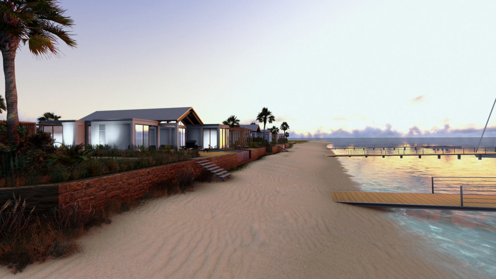

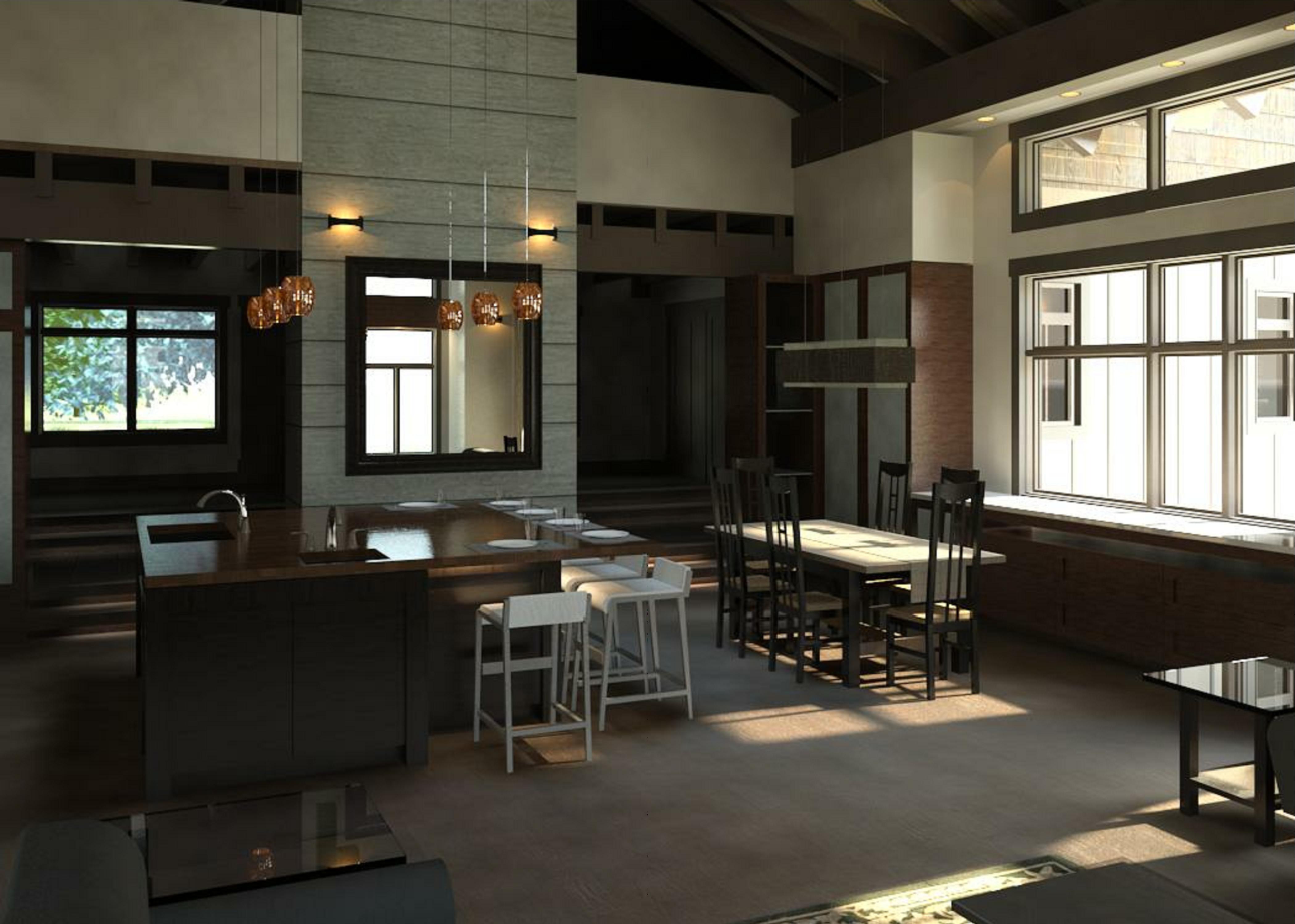

Hi All,

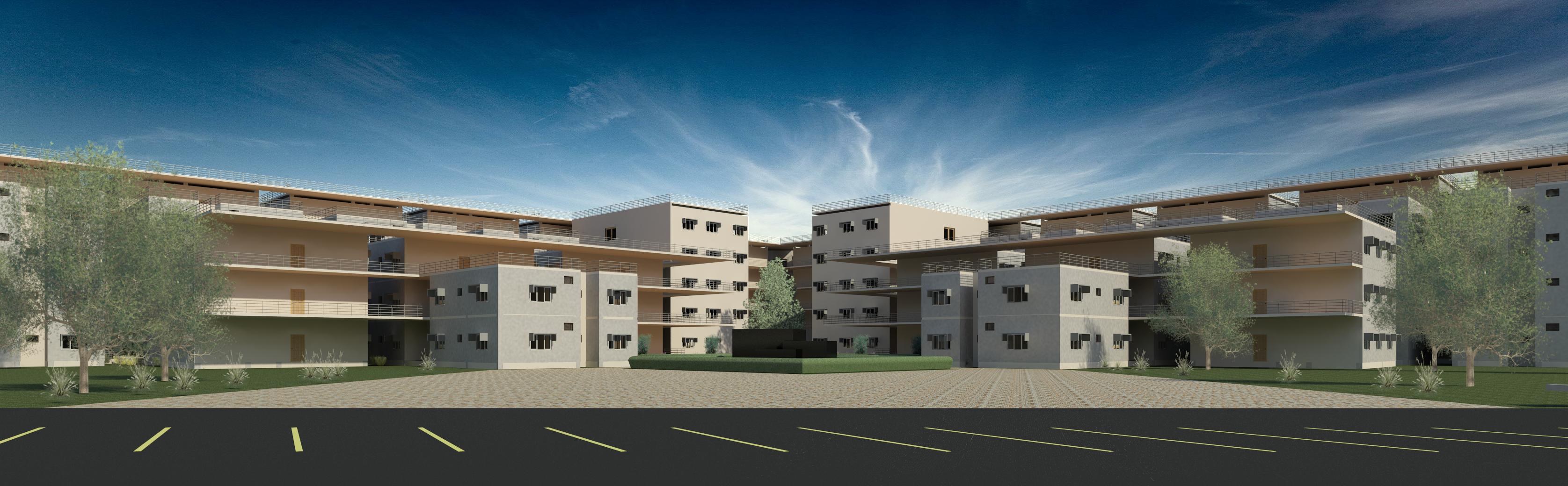

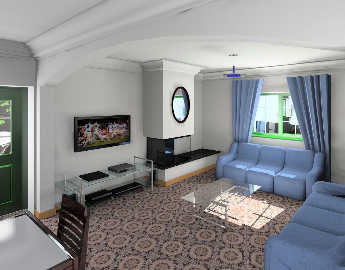

At present, considering cost and complexity, I can vote for the quality of what Revit is capable off. I have done extensive research into finding a solution that can provide faster renderings and although there seems to be many, the workflow is almost always broken due to requirements in duplicating work. 3D max is not only expensive, but extremely complex and then to say that you have to spend additional money on a plug-in like Maxwell or V-ray or Octane or Felix is just ridiculous. Currently Revit can receive add-ins or plug-ins from render packages like Twinmotion and Indigo but both seem to export to a standalone package. This in itself is not negative although with a fully loaded Revit model export files almost always have flaws.
I have attached a couple of renderings that I did in Revit, as reference. These are direct products of Revit with not Photoshop or other touch-ups.These took approx. 96 hours each...
I am hoping to find someone that can provide some direction in creating virtual tour images in Revit. I understand that there is plenty of software available that can stitch these together and create the virtual tour file, the question is more about how to set up the rendering in Revit.
Any thoughts would be appreciated.

d3ii- how many frames would you stitch together at 96 hours each? if you have to do an animation like that of your revit project then you would want to export to 3Ds Max- as animation is really what that program is for.. otherwise revit will do a shaded-line animation- or a "walk-through".. seems like many of us forget that revit is primarily a construction design and documentation program..

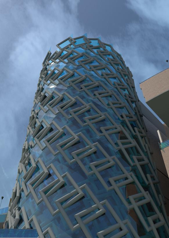

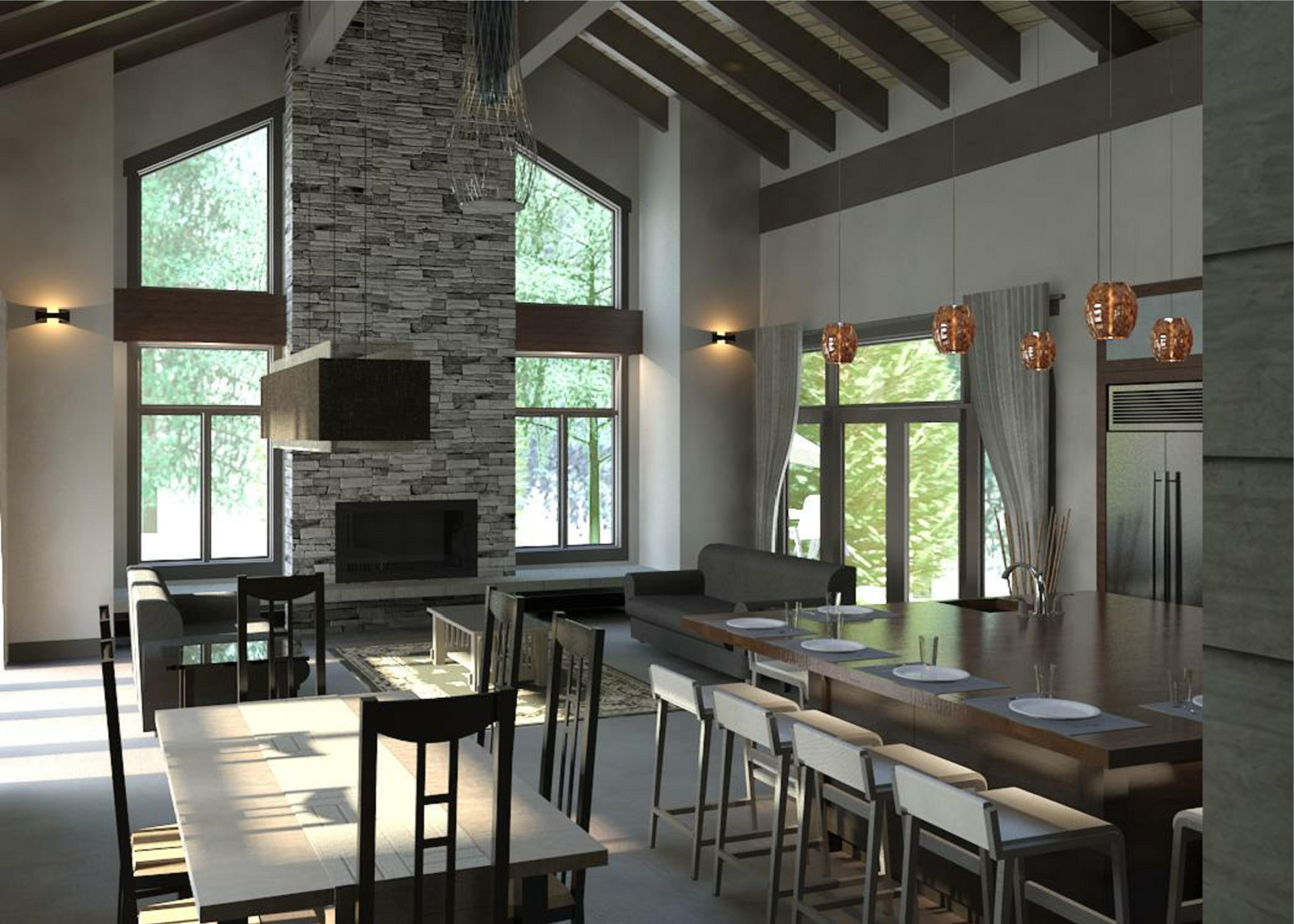

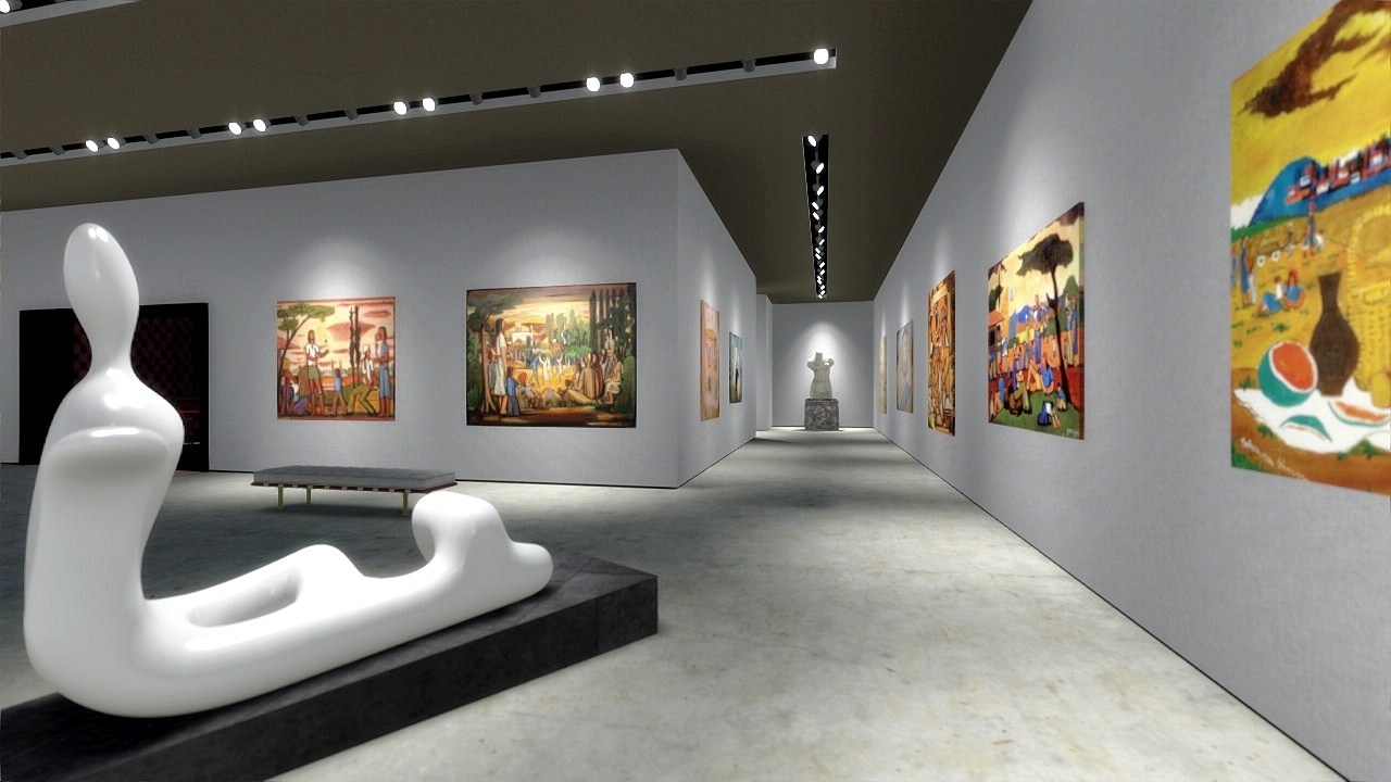

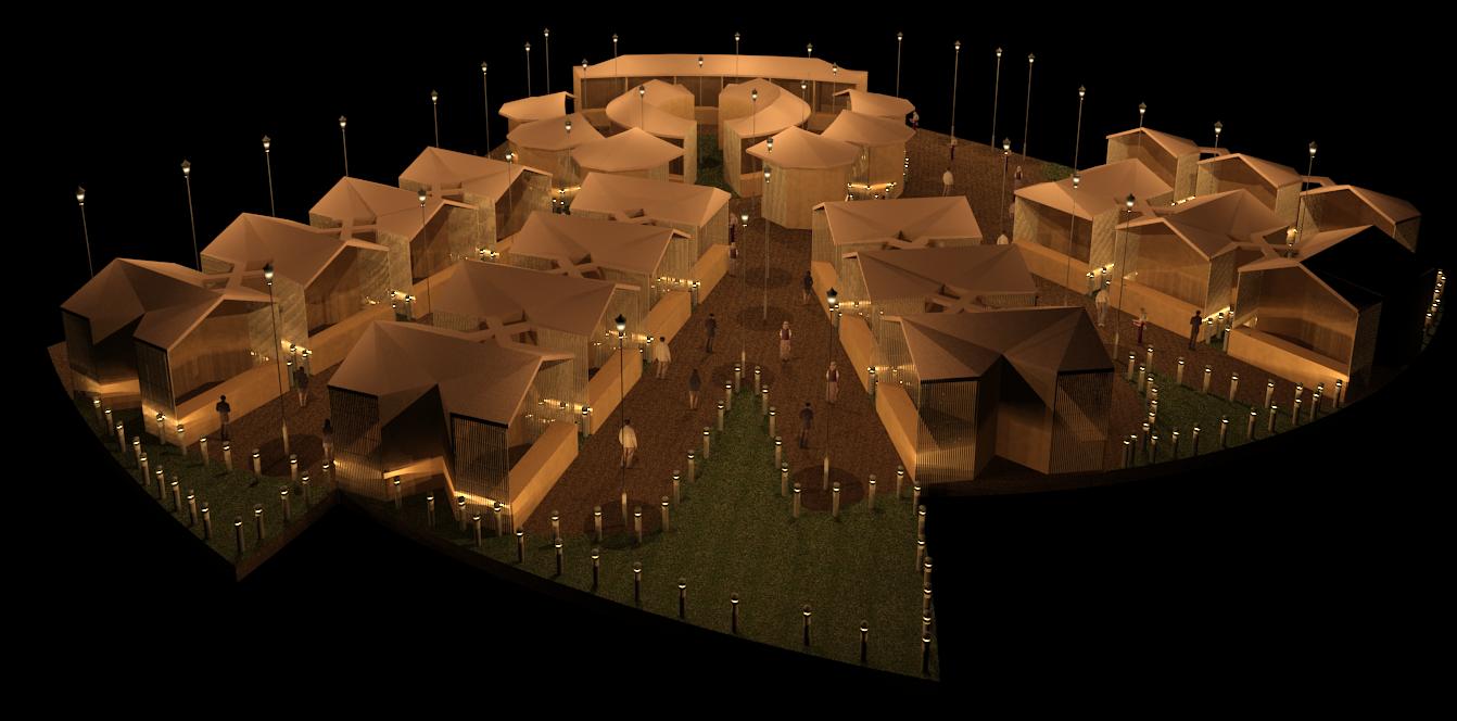

these are my renders through variour verrions of revit, i think over time its become pretty decent, still realy slow though.
