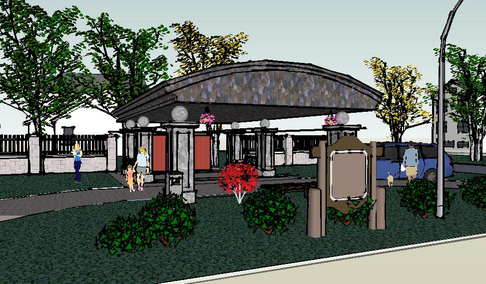

AutoCAD 2007 3D is awesome and it does work just like sketchup but with your AutoCAD skills and AutoCAD accuracy.
If you want to learn all the new AutoCAD 2007 3D stuff I've got 32 brand new CADclip videos free for download at http://www.cadclips.com/ACAD2007-3D.htm
Then you can import your autocad solid models into Sketchup and add trees, fencing, benches....airplanes....
See attached SKP file started in AutoCAD 2007 3D then imported into Sketchup and touched up.
