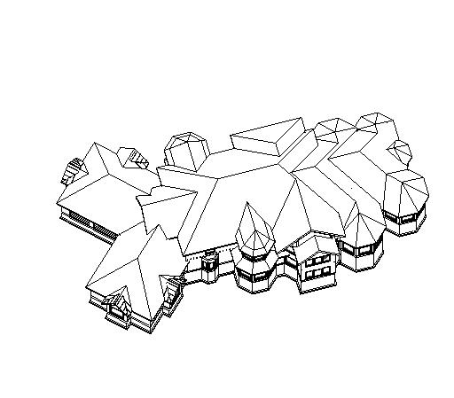

I think the Key to Making a complex roof is Breaking it up into diffrent roof objects. Take a look. This was done with many diffrent roof objects. Post edited on 2006-06-27 08:40:38

you are correct, i always break complex roofs up into smaller roofs based on the different plate heights as one factor
