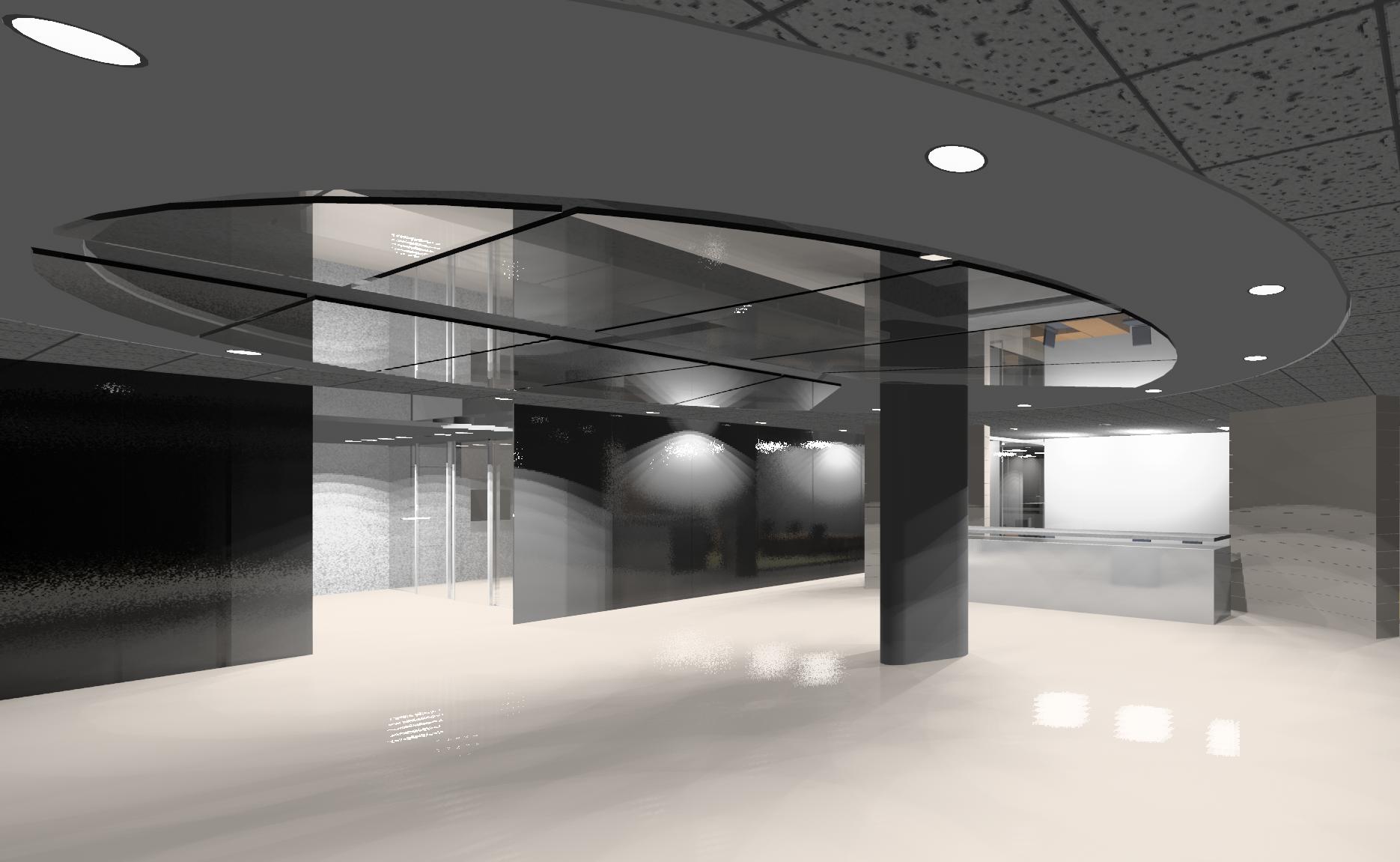

revit can produce much more realistic pics than posted, i worked on revit for a month now and i've come with much more impressive shots u just need to fiddle with every option there

although i have a modest experience in revit , it can produce realstic renderings, if u can handle accurender materials and lighting , but its taking for ever to render,
but on the other hand other rendering engines , max or viz for example, are more user friendly , and gives u more powerfull parameters and options to control, and eventually photorealism in a shorter time ..
just remember u'll have to reassign materials and re introduce lights in all light fixtures after u imported ur model from revit , i still cant import a model from revit and mantain material assignment and lighting fixtures,
one other thing i used to use ies files in lights in max and it gave a realistic rendering for lights , i cant seem to get ies files to work for revit rendering, i downloaded revit mep and assigned an ies file to the light fixture and for some reason its lighting in the rendering view is the same, can any one advice!! thanx
