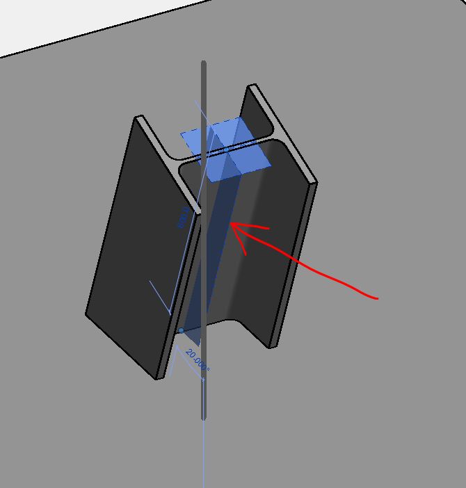

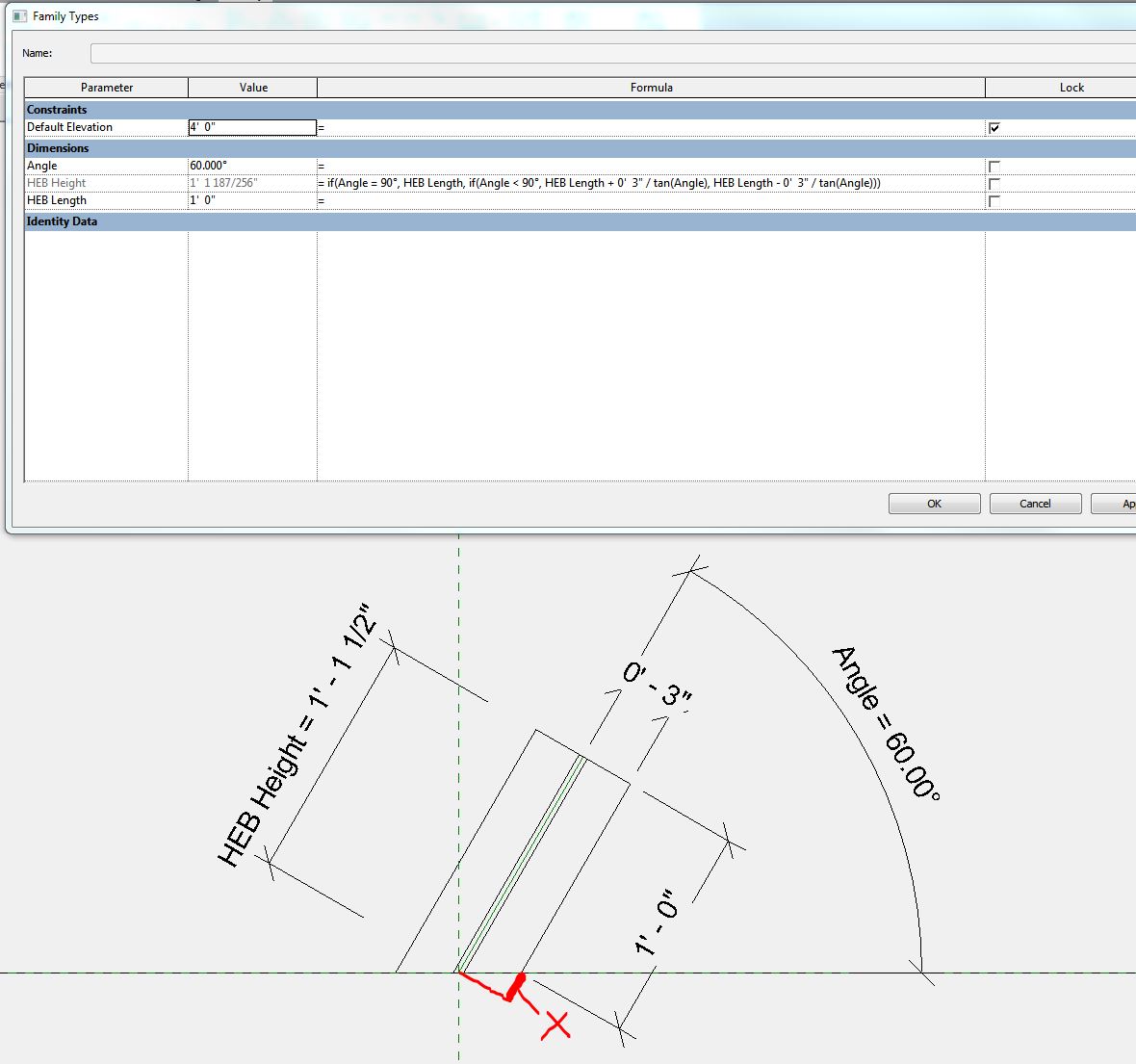

Void extrusion supposed to be on the ref line’s ref plane – see pic1. Make it current and draw a profile on it. HEB sweep appears to be correct. You have your parameters messed up a little, I think. I’m not sure what 'HEB hf' is doing and there is an error when entering any angle value. Take a look at the pic2. I’ve come up with a different formula. What it says is: if ‘Angle’ is 90, use ‘HEB Length’ (which is 1’-0” in this case), if ‘Angle’ is less than 90, add X to ‘HEB Length’, if ‘Angle’ is more than 90, subtract X from ‘HEB Length’. That’s basically what I’ve already written before, in my previous post.

@pijpiwo, thanks to your hints, I've created needed HEB element with endplates. It occurs that all of my problems came from reference line as plane.
