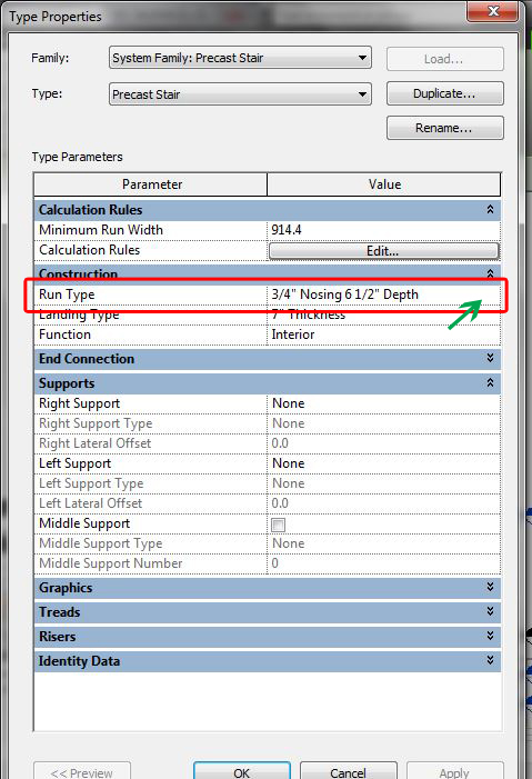

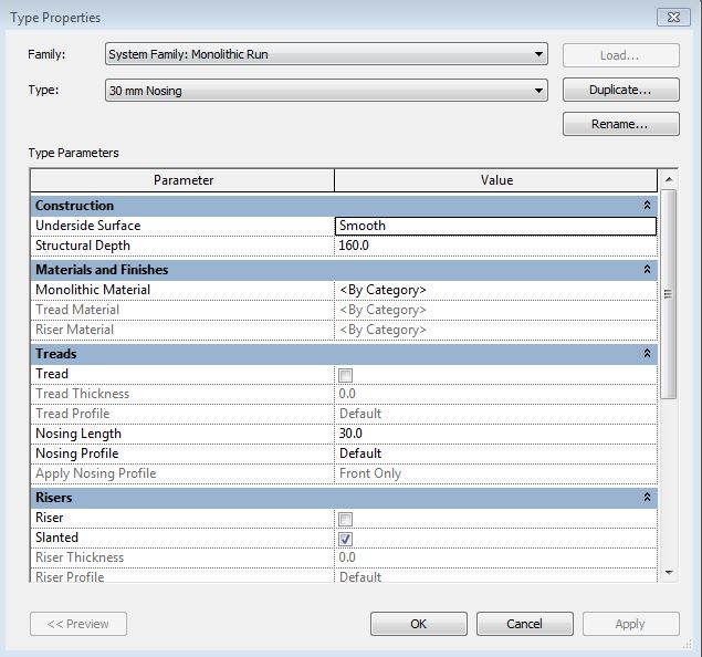

@DAMAREVIT Open your stairproperties. The click right of the "Run Type" row. You'll see a grey square with three dots in it.
Click on this square, this opens an new window showing the properties of your "Run Type".
The parameter you need to change is "Structural Depth" (see images attached)
@WWHUB See that wasn't too hard.

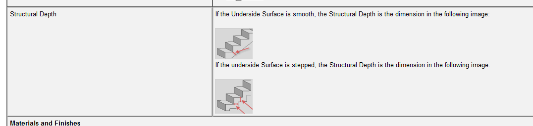

Kim - you did not read all of the posts.  This user's initial post did not indicate he was using stair by component and I responded as if he were doing stair by sketch and my response for that was correct.  He was missing function because he was missing updates.  However, I guess I should have looked closer at the images he later posted to see that he was doing stair by component and in that case, the setting is in a different location as you have pointed to.  But this setting is ONLY for COMPONENT stairs
For other users - component stairs, read this help topic.
TheRun Component Type Properties
