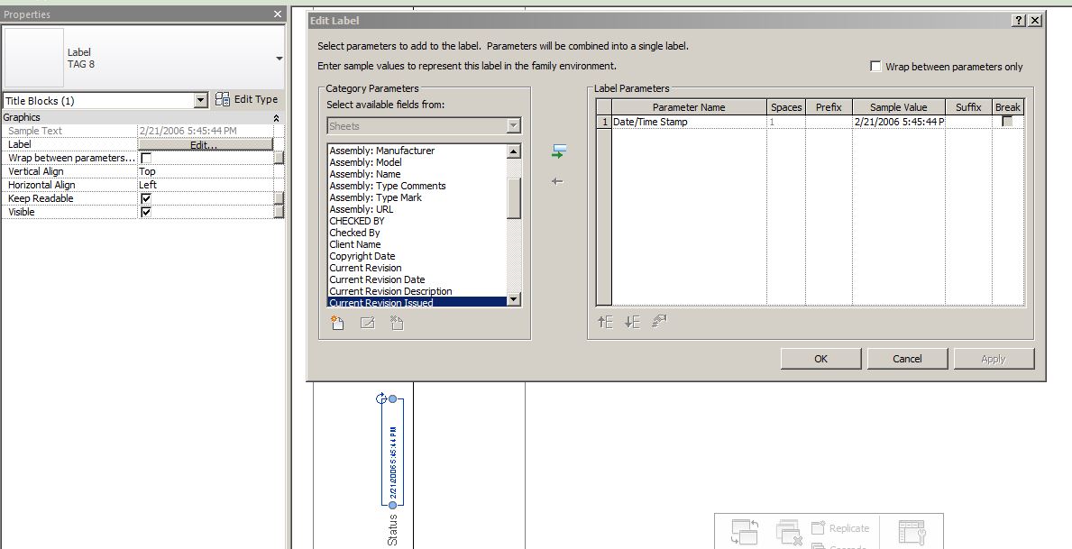

IS THIS THREAD ABOUT UPDATING THE DATE ON SHEETS AUTOMATICALLY. IM HAVING A HARD TIME TO FIGURE IT OUT. THAT IS WHAT IM TRYING TO DO. UPDATE THE DATE ON MY SHEETS AUTOMATICALLY WHEN I OPEN IT UP AND EDIT IT.
Thu, Apr 28, 2016 at 10:21:35 AM | Format Label Date/ Time Stamp
#19
Revit has a built in Date/Time stamp parameter that is available for sheets.   We place ours off to the left of the sheet in the binding area.  It adjusts everytime you open the sheet.  See image
