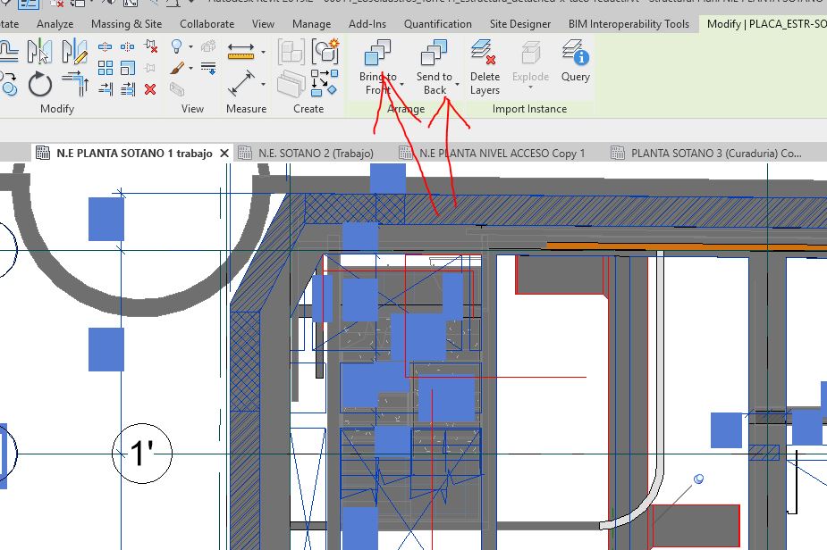

Tue, Jul 9, 2019 at 10:03:19 AM | Masking region hierarchy
#19
sllana
Joined: Wed, Mar 2, 2011
106 Posts
5 Stars: 2 Votes
have you tried using these? (image)
